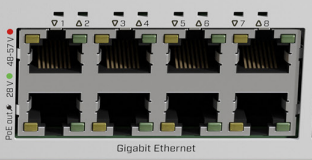

PoE-Out​
  • PoE-Out 802.3 af/at and passive PoE
  • PoE-Out ports ether1-ether8:PoE-Out voltage: low voltage 28V;
  • high voltage 54V (AC input) or 48-57V (DC Input)
  • Maximum low voltage PoE-Out output current: 1000 mA (per port).
  • Maximum high voltage PoE-Out output current: 625 mA (per port).
  • Total output power 140 W. PoE-Out high voltage varies depending on the power supply: if an AC power supply is used PoE-Out high voltage will always be ~54V; if a DC Jack power supply is used PoE-Out high voltage will match the input voltage on the DC Jack. PoE-Out low voltage is constant at ~28V. *if AC and DC power supplies are used simultaneously PoE-Out high voltage will depend on the higher input voltage. It will change only if the DC Jack input exceeds 54 volts.

LED​
The power supply will be determined by a device and given the appropriate Voltage if it's low the LED will light Green if the requirement is the high LED will light red, and none when no power is required for the client device.

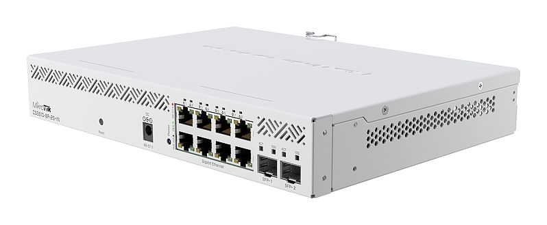

Extension slots and ports​
  • Product code CSS610-8P-2S+IN.
  • A number of 1G Ethernet ports 8.
  • A number of 10G SFP+ ports 2.
  • Switch chip model 88E6193X.
  • Dimensions 272 x 216 x 50 mm.
  • Operating temperature -40°C to +70°C.

Mounting​
The device is designed to use indoors and it can be mounted in a rackmount enclosure using provided rack mounts, or it can be placed on the desktop. Use a Phillips screwdriver to attach rackmount ears on both sides of the device if designated use is for rackmount enclosure:
  • Attach rack ears to both sides of the device and tighten four screws to secure them in place, as shown in the picture.
  • Place the device in a rackmount enclosure and align with the holes so that the device fits conveniently.
  • Tighten screws to secure it in place. The device has no protection from water contamination, please ensure the placement of the device in a dry and ventilated environment. The mounting and configuration of this device should be done by a qualified person. We recommend using Cat6 cables for our devices.
