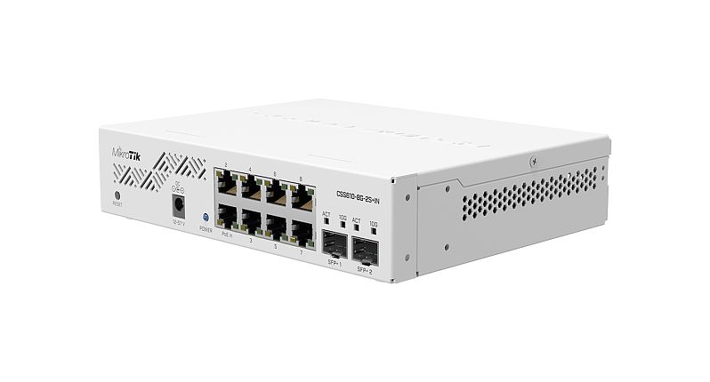

CSS610-8G-2S+IN
Eight 1G Ethernet ports and two SFP+ ports for 10G fiber connectivity. Portable, powerful and extremely cost-effective – this switch is an instant classic! See the CSS610-8G-2S+IN product page for full specifications and brochures.
