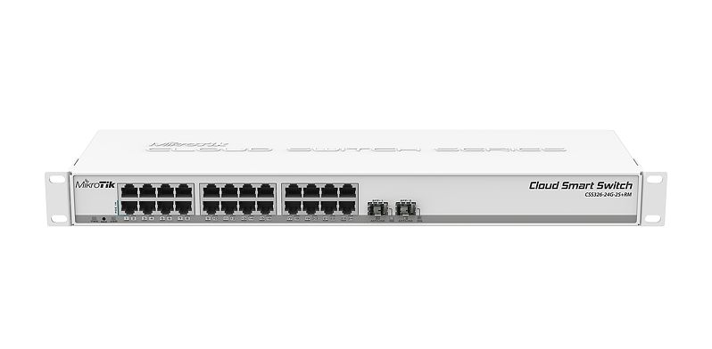

CSS326-24G-2S+RM
The CSS is a switch with 24 Gigabit Ethernet ports and two SFP+ ports. All ports are connected through a switch chip. The device runs SwOS operating system, specifically made for Switches. See the CSS326-24G-2S+RM product page for full specifications and brochures.
