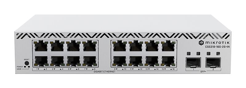

CSS318-16G-2S+IN
With 16 Gigabit Ethernet ports and 2 SFP+ 10G uplink ports, you get all the connectivity you need without unnecessary bulk. Stack two units side by side in a single 1U rack space for even greater flexibility and scalability. See the CSS318-16G-2S+IN product page for full specifications and brochures.

The device is designed to use indoors and it can be mounted in a rackmount enclosure using provided rack mounts, or it can be placed on the desktop. Use a Phillips screwdriver to attach rackmount ears on both sides of the device if designated use is for rackmount enclosure:
  • Attach rack ears to both sides of the device and tighten four screws to secure them in place, as shown in the picture.
  • Place the device in a rackmount enclosure and align with the holes so that the device fits conveniently.
  • Tighten screws to secure it in place. The device has no protection from water contamination, please ensure the placement of the device in a dry and ventilated environment. The mounting and configuration of this device should be done by a qualified person. We recommend using Cat6 cables for our devices.
