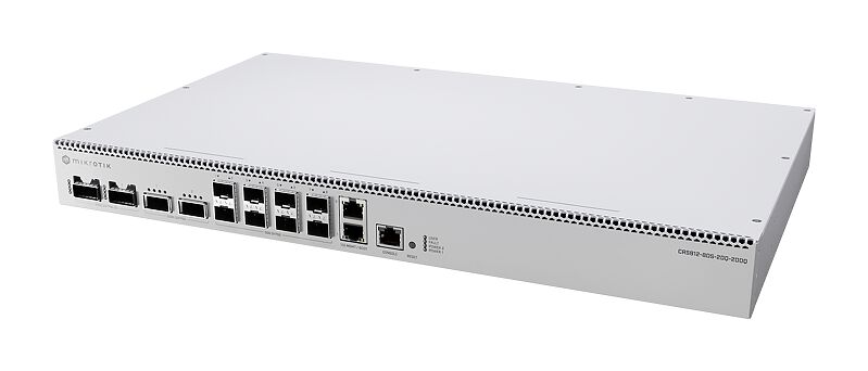

CRS812-8DS-2DQ-2DDQ-RM
This switch is your next leap forward – a powerful, efficient, and cost-effective way to bring 50G, 200G, and 400G into your rack. Quad-core 2 GHz ARM CPU, dual-redundant power supplies and 4x hot-swap cooling fans, 2x 10G Ethernet, 8x 50G SFP56, 2x 200G QSFP56, and 2x 400G QSFP56-DD ports. See the CRS812 DDQ product page for full specifications and brochures.

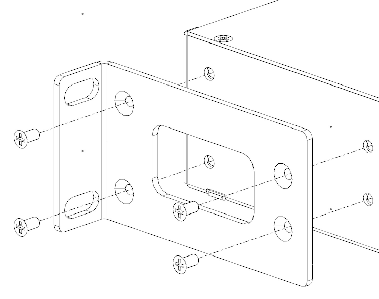

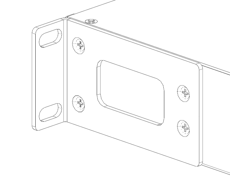

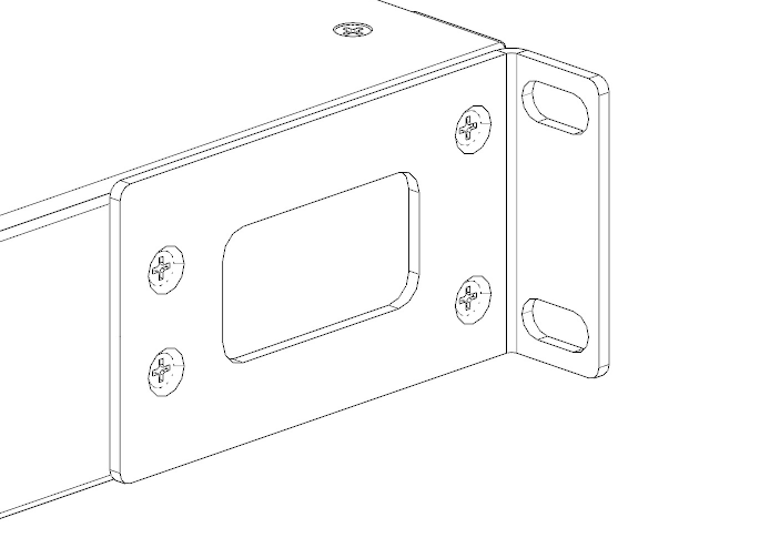

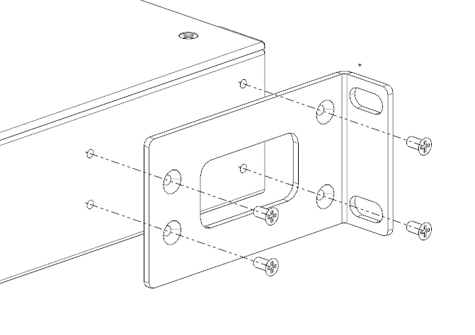

Mounting​
The device is designed for indoor use and can be either mounted in a rack enclosure using the provided rackmount brackets or simply placed on a desktop. Please attach rubber pegs on the bottom of the router if the desired placement is on the flat surface or use a Phillips screwdriver to attach rackmount ears on both sides of the device if designated use is for rackmount enclosure:
  • Attach the Rackmount ears to the front sides of the device.
  1. Attach the small rear Rackmount support ears to both sides of the device.
  1. Attach the long rear Rackmount support ears to the rack’s rear side.
  1. Install the device in the rack, ensuring that the case support ears are securely fixed to the long support ears.
The device has no protection from water contamination, please ensure the placement of the device in a dry and ventilated environment. We recommend Cat6 cables for our devices. Mounting and configuration of this device should be done by a qualified person.

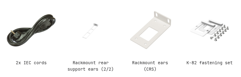

Accessories​
Package includes the following accessories that come with the device:
