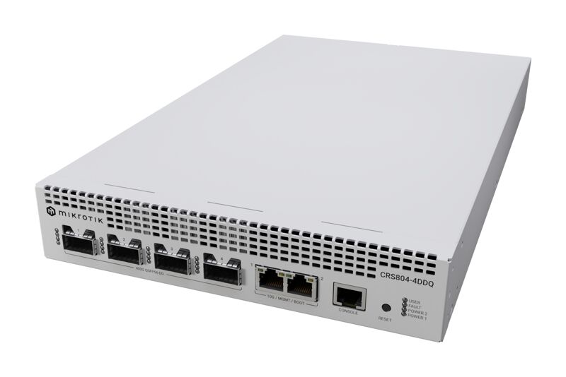

  • Product code: CRS804-4DDQ-hRM.
  • CPU: Quad-Core AL52400 2000 MHz.
  • CPU: architecture ARM 64bit.
  • Size of RAM: 4 GB.
  • RAM type: DDR4.
  • Storage: 512 MB, NAND.
  • Number of 10M/100M/1G/10G Ethernet ports: 2. Marked as MGMT/BOOT. It is possible to set Ether1 or Ether2 as the Etherboot portin System → RouterBOARD → Settings → Etherboot Port.
  • Number of 400G QSFP56-DD ports: 4.
  • PoE-out ports: Ether9-Ether16, 802.3af/at, Total output power 150 W.
  • 1x RJ45 console port (set at 115200bits/s, 8 data bits, 1 stop bit no parity).
  • Switch chip model: 98DX7335.
  • Dimensions: 387 x 218 x 44 mm.
  • Operating system RouterOS: v7, License level 6.
  • Operating temperature: -10°C to +60°C.
  • IP: 20 See the MikroTik wired interface compatibility table for supported SFP modules.

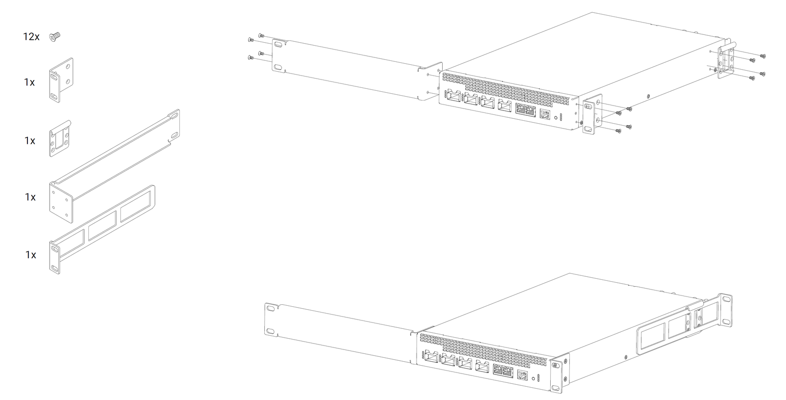

The device is intended for indoor use and can be mounted in a 1U rackmount enclosure using the supplied rackmount accessories, or placed on a flat surface. For desktop installation, attach the supplied rubber feet to the bottom of the device. For rackmount installation, use a Phillips screwdriver to attach the rackmount ears to the device as described below.
Single device installation in a 1U rackmount enclosure​
  • Attach the front rackmount bracket to one side of the device.
  • Attach the long rackmount bracket to the opposite side.
  • Attach the rear support ear to the device.
  • Secure all brackets using four screws, as shown in the illustration.
  • Place the device into the rackmount enclosure and align it with the mounting holes.
  • Tighten the rack screws to secure the device in place.

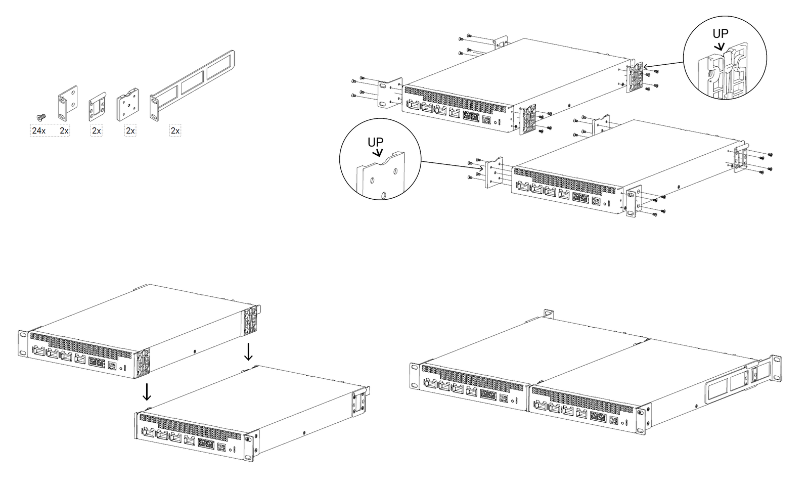

Installing two CRS804-4DDQ-hRM devices using RMK-2x10/19​
Using the RMK-2x10/19 kit (included in the package), it is possible to mount two CRS804-4DDQ-hRM devices side by side within a single 1U rack unit.
  • Attach the front rackmount bracket and the rear support ear to the same (opposite) side of each device.
  • Secure each bracket using four screws, as shown in the illustration.
  • Attach the RMK-2x10/19 mounting parts to the remaining sides of both devices.
  • Secure the RMK-2x10/19 parts using four screws, as shown in the illustration.
  • Align and latch the two devices together according to the mounting guide.
  • Place the assembled unit into the rackmount enclosure and align it with the mounting holes.
  • Tighten the rack screws to secure the assembly in place.

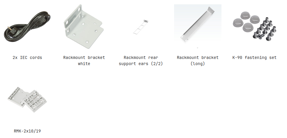

Package includes the following accessories that come with the device:
