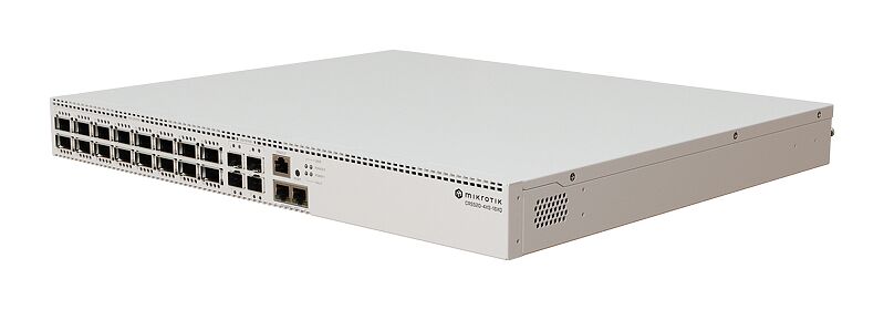

CRS520-4XS-16XQ-RM
An ultra-fast enterprise switch with extra processing power due to the CCR series CPU & the best price per 100 Gigabit port on the market! See the CRS520-4XS-16XQ-RM product page for full specifications and brochures.

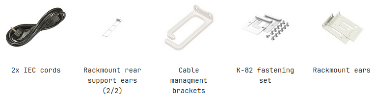

Accessories​
Package includes the following accessories that come with the device:
