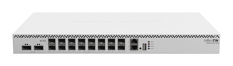

Extension slots and ports​
  • Product code CRS518-16XS-2XQ-RM.
  • Switch chip model 98DX8525.
  • CPU QCA9531 650 MHz.
  • CPU architecture MIPSBE.
  • CPU core count 1.
  • Size of RAM 64 MB.
  • RAM type DDR2.
  • Storage 16 MB, Flash.
  • A number of 100M Ethernet ports 1.
  • A number of 25G SFP28 ports 16.
  • A number of 100G QSFP28 ports 2.
  • USB port 1 (type A).
  • Operating system Only v7 RouterOS.
  • Dimensions 443 x 265 x 44.5 mm.
  • Operating temperature -40°C to +70°C.
  • 100G QSFP28 supported speeds: 1x 100G; 2x 50G; 1x 50G; 1x 40G; 4x 25G; 4x 10G; 4x 1G. Not supported: 2x 40G
  • 25G SFP28 supported speeds: 1x 25G; 1x 10G; 1x 2.5G; 1x 1G. Not supported: 1x 5G
