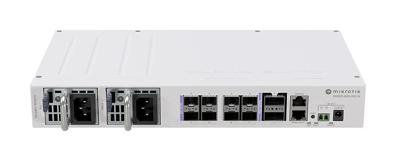

CRS510-8XS-2XQ-IN
A versatile 100 Gigabit switch that offers speed, value, and diverse connectivity options. 2x 100 Gigabit QSFP28 ports, 8x 25 Gigabit SFP28 ports, dual hot-swap power supplies. See the CRS510-8XS-2XQ-IN product page for full specifications and brochures.

Mounting​
The device is designed to use indoors and it can be mounted in a rackmount enclosure using provided rack mounts, or it can be placed on the desktop. Please attach rubber pegs on the bottom of the router if the desired placement is on the flat surface or use a Phillips screwdriver to attach rackmount ears on both sides of the device if the designated use is for rackmount enclosure:
  • Attach rack ears to both sides of the device and tighten four screws to secure them in place, as shown in the picture.
  • Place the device in a rackmount enclosure and align it with the holes so that the device fits conveniently.
  • Tighten screws to secure it in place.
The IP rating scale for this device is IPX0. The device has no protection from water contamination, please ensure the placement of the device in a dry and ventilated environment. We recommend shielded Cat5/6 cables for our devices. The mountingand configuration of this device should be done by a qualified person.

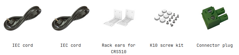

Accessories​
The package includes the following accessories that come with the device:
