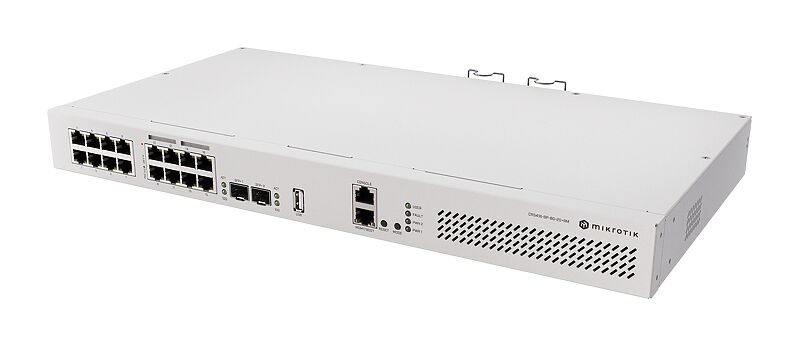

CRS418-8P-8G-2S+RM
You wanted a switch that could do more. So we built one that does everything! 16x (+1) Gigabit Ethernet ports (8x with PoE-out), dual 10G uplinks, and a powerful quad-core 2.2 GHz ARM CPU. Powerful enough to replace most small/medium office routers, ~3x faster than a CRS320 or a CRS328… and for a better price! See the CRS418-8P-8G-2S+RM product page for full specifications and brochures.

  • Product code: CRS418-8P-8G-2S+RM.
  • CPU: Quad-Core IPQ-8072 2.2 GHz.
  • CPU: architecture ARM 64bit.
  • Size of RAM: 1 GB.
  • RAM type: DDR3L.
  • Storage: 128 MB, NAND.
  • Number of 1G Ethernet ports: 17.
  • Number of 10G SFP+ Ethernet ports: 2.
  • Number of 1G Ethernet ports with PoE-out: 8.
  • PoE-out ports: Ether9-Ether16, 802.3af/at, Total output power 150 W.
  • 1x RJ45 console port (set at 115200bits/s, 8 data bits, 1 stop bit no parity).
  • USB: 1 USB 3.0 type A.
  • Switch chip model: 98DX226S.
  • Dimensions: 443 x 156 x 44 mm.
  • Operating system RouterOS: v7, License level 5.
  • Operating temperature: -20°C to +70°C.
  • IP: 20. Please visit help pages for MikroTik SFP module compatibility and configuration table: MikroTik wired interface compatibility

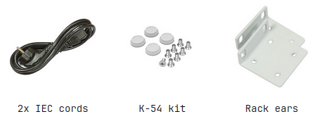

Accessories​
Package includes the following accessories that come with the device:
