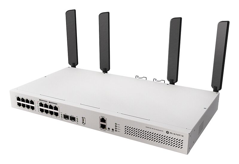

The device is designed for indoor use and can be mounted in a rack enclosure using the provided rackmount brackets or placed on a desktop.
If installing the device in a rack, ensure there is enough space for the antennas and that they can be positioned freely without obstruction.For desktop placement, attach the rubber feet to the bottom of the router.
For rack installation, use a Phillips screwdriver to attach the rackmount ears on both sides of the device:
  • Attach the rackmount ears and the rear support ears to both sides of the device and tighten the four screws to secure them, as shown in the picture.
  • Place the device in the rackmount enclosure and align it with the mounting holes.
  • Tighten the screws to secure the device in place. The device has no protection from water contamination, please ensure the placement of the device in a dry and ventilated environment. We recommend Cat6 cables for our devices. Mounting and configuration of this device should be done by a qualified person.

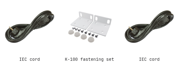

Accessories​
Package includes the following accessories that come with the device:
