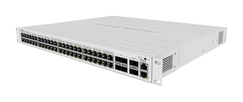

CRS354-48P-4S+2Q+RM
The CRS354 is a network switch with 48 Gigabit ports supporting PoE out for your devices, four 10G SFP+ ports, two 40G QSFP+ ports. The device is ready to use as a switch. See the CRS354-48P-4S+2Q+RM product page for full specifications and brochures.

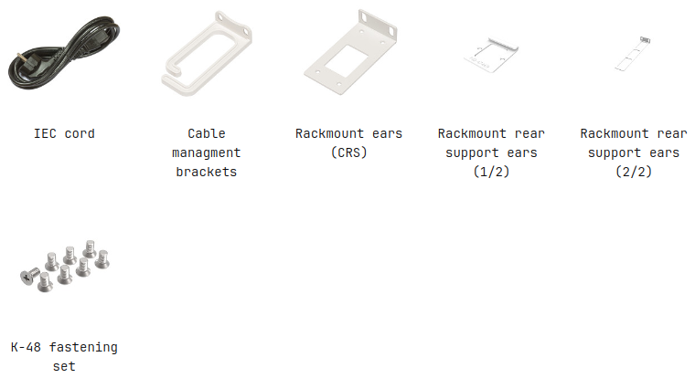

The device is designed to use indoors and it can be mounted in a rackmount enclosure using provided rack mounts, or it can be placed on the desktop. Use a Phillips screwdriver to attach rackmount ears on both sides of the device and for both sides of the back of the device if designated use is for rackmount enclosure:
  • Attach the bracket to the front right side.
  • Attach the rear right bracket.
  • Attach the bracket to the left front side.
  • Attach the rear left bracket.
  • Attach long brackets to the rackmount and install the device with the holes so that the device fits conveniently.
  • If needed, install cable management brackets.

Accessories​
The package includes the following accessories that come with the device:
