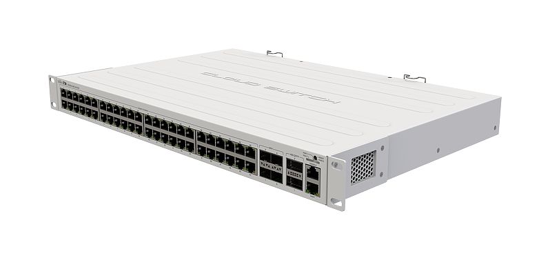

The CRS354-48G-4S+2Q+RM is a network switch with 48 Gigabit ports and four 10G SFP+ ports, and two 40G QSFP+ ports. The device is ready to use as a switch. See the CRS354-48G-4S+2Q+RM product page for full specifications and brochures.

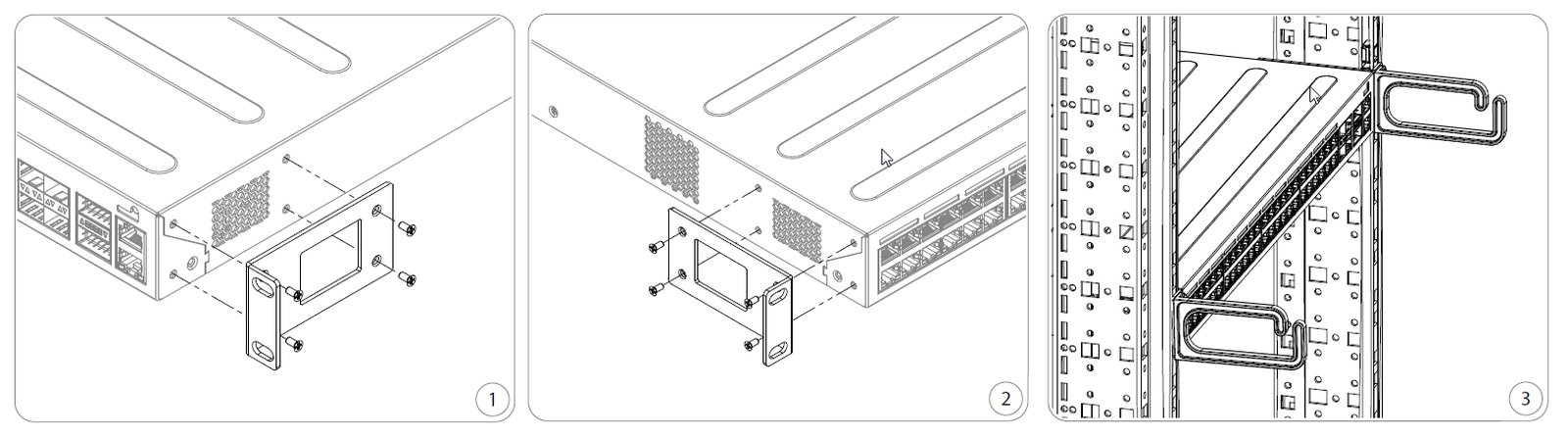

Mounting​
The device is designed to use indoors and it can be mounted in a rackmount enclosure using provided rack mounts, or it can be placed on the desktop. Use a Phillips screwdriver to attach rackmount ears on both sides of the device:
  • Attach the Rackmount ears to the front right side.
  • Attach the Rackmount ears to the front left side.
  • If needed, install cable management brackets.

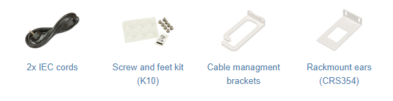

Accessories​
The package includes the following accessories that come with the device:
