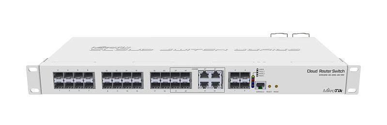

CRS328-4C-20S-4S+RM
Smart Switch, 20 x SFP cages, 4 x SFP+ cages, 4 x Combo ports (Gigabit Ethernet or SFP), 800MHz CPU, 512MB RAM, 1U rackmount case, Dual Power Supplies, RouterOS L5 or SwitchOS (Dual Boot). See the CRS328-4C-20S-4S+RM product page for full specifications and brochures.

| Product Code | CRS328-4C-20S-4S+RM |
| CPU | 98DX3236, 800 MHz |
| CPU Architecture | ARM 32bit |
| CPU Core Count | 2 |
| Switch Chip Model | 98DX3236 |
| RAM | 512 MB |
| Storage | 16 MB Flash |
| Combo Ethernet/SFP Ports | 4 |
| SFP Ports | 20 |
| SFP+ Ports | 4 |
| Serial Console (RJ45) | 1 |
| Operating System | RouterOS (license level 5) / SwitchOS (Dual boot) |
| Operating Temperature | -20 °C to +60 °C |
| Case Dimensions | 443 × 194 × 44 mm |
