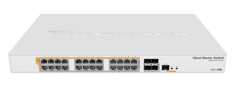

CRS328-24P-4S+RM
24 port Gigabit Ethernet router/switch with four 10Gbps SFP+ ports in 1U rackmount case, Dual Boot and PoE output, 500W. See the CRS328-24P-4S+RM product page for full specifications and brochures.

LED indicators​
  • PWR LED is lit when the router is powered on.
  • The use of LEDs can be configured from RouterOS.
  • Triangle LEDs (top row) indicate PoE out status. Green LED indicates that the respective port uses low voltage, a red LED indicates high voltage. Flashing single green LED: problem to start a low voltage device. Flashing single red LED: problem with high voltage device.
  • The square port LEDs (bottom row) indicate the individual Ethernet, SFP port activity.
  • FAN FAULT LED indicates a problem with any of the cooling fans.
  • PoE FAULT LED indicates an exceeded overall max PoE output limit. Port PoE-out priorities will work in 3 independent sections (8 ports each) and overload will happen in any section that breach 150W consumption
