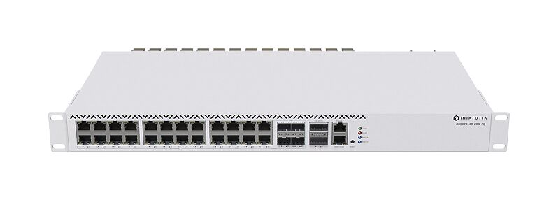

The CRS326-4C+20G+2Q+RM is a network switch with twenty 2.5G Ethernet ports, four 2.5/10G SFP+ ports and one 100M and two 40G QSFP+ ports. The device is ready to use as a switch. See the CRS326-4C+20G+2Q+RM product page for full specifications and brochures.

The device is designed to use indoors and it can be mounted in a rackmount enclosure using provided rack mounts, or it can be placed on the desktop. Please attach rubber pegs on the bottom of the router if the desired placement is on the flat surface or use a Phillips screwdriver to attach rackmount ears on both sides of the device if designated use is for rackmount enclosure:
  • Attach rack ears to both sides of the device and tighten four screws to secure them in place, as shown in the picture.
  • Place the device in a rackmount enclosure and align with the holes so that the device fits conveniently.
  • Tighten screws to secure it in place.
