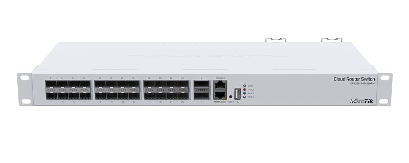

CRS326-24S+2Q+RM
The CRS326 is a network switch with 24 10G SFP+ ports and two QSFP+ 40G ports. The device is ready to use as a switch. See the CRS326-24S+2Q+RM product page for full specifications and brochures.

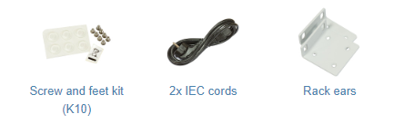

Accessories
Package includes the following accessories that come with the device:
