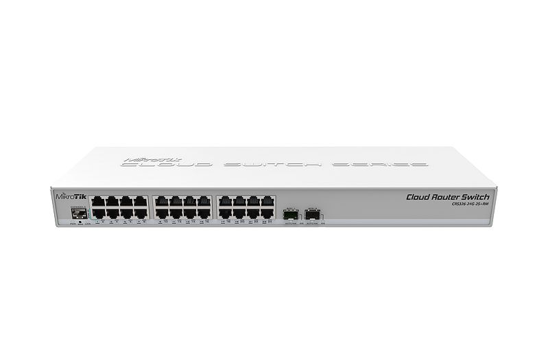

CRS326-24G-2S+RM
24 Gigabit port switch with 2 x SFP+ cages in 1U rackmount case, Dual boot (RouterOS or SwitchOS). See the CRS326-24G-2S+RM product page for full specifications and brochures.
