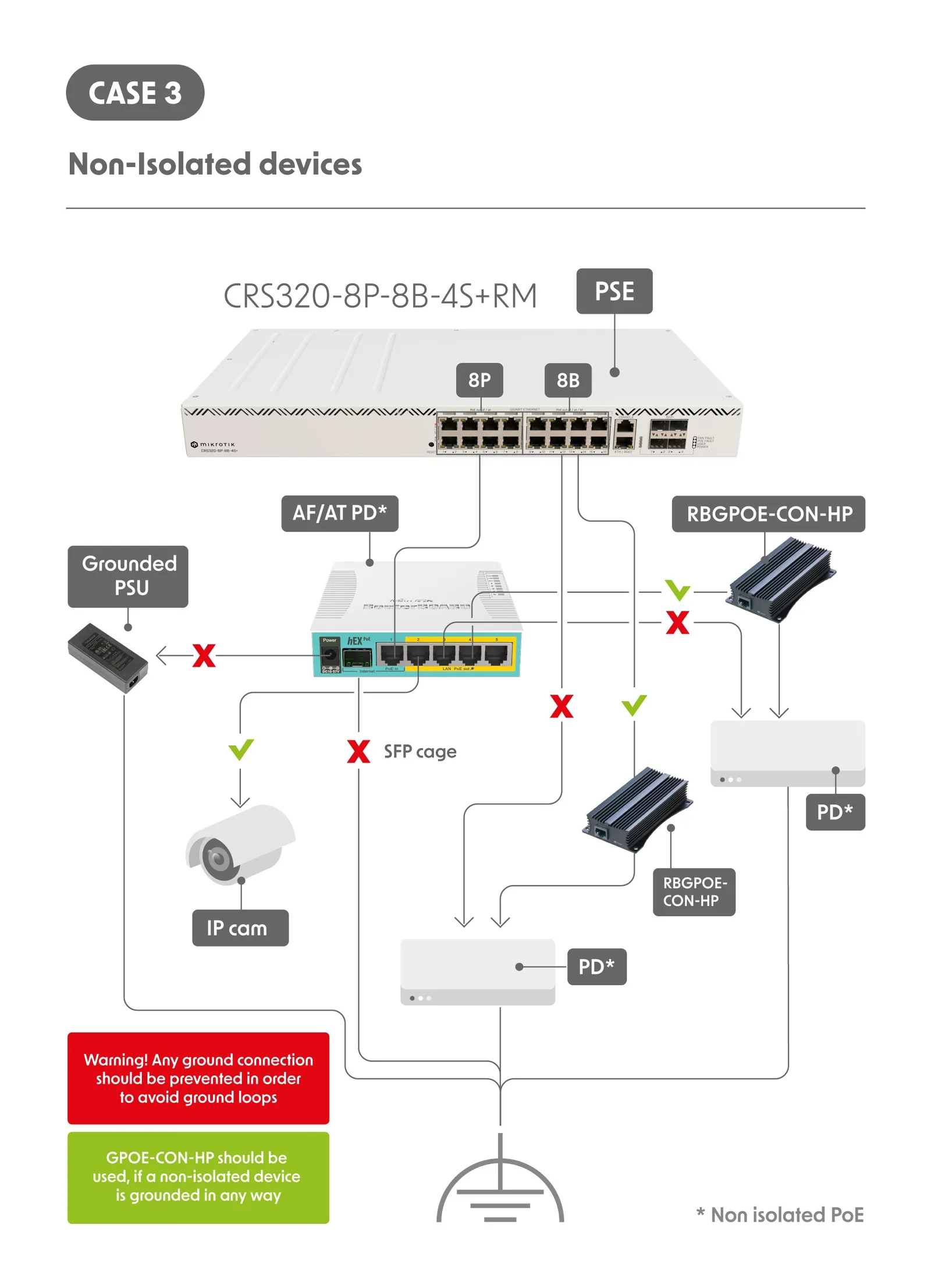

Non-isolated devices like NetMetal ax can cause ground loop issues, if ground path is produced by PSU or earthing cable. If such device is required, RBGPOE-CON-HP should be used to provide galvanic isolation

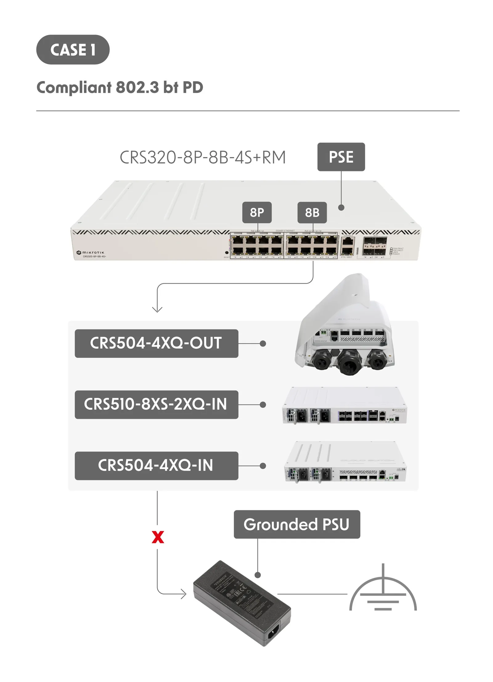

An 802.3 af/at/bt device, such as the CRS504-4XQ-OUT, CRS510-8XS-2XQ-IN, or CRS504-4XQ-IN , can be connected to one of the 8B ports, but it shouldn't be additionally connected with a grounded PSU.

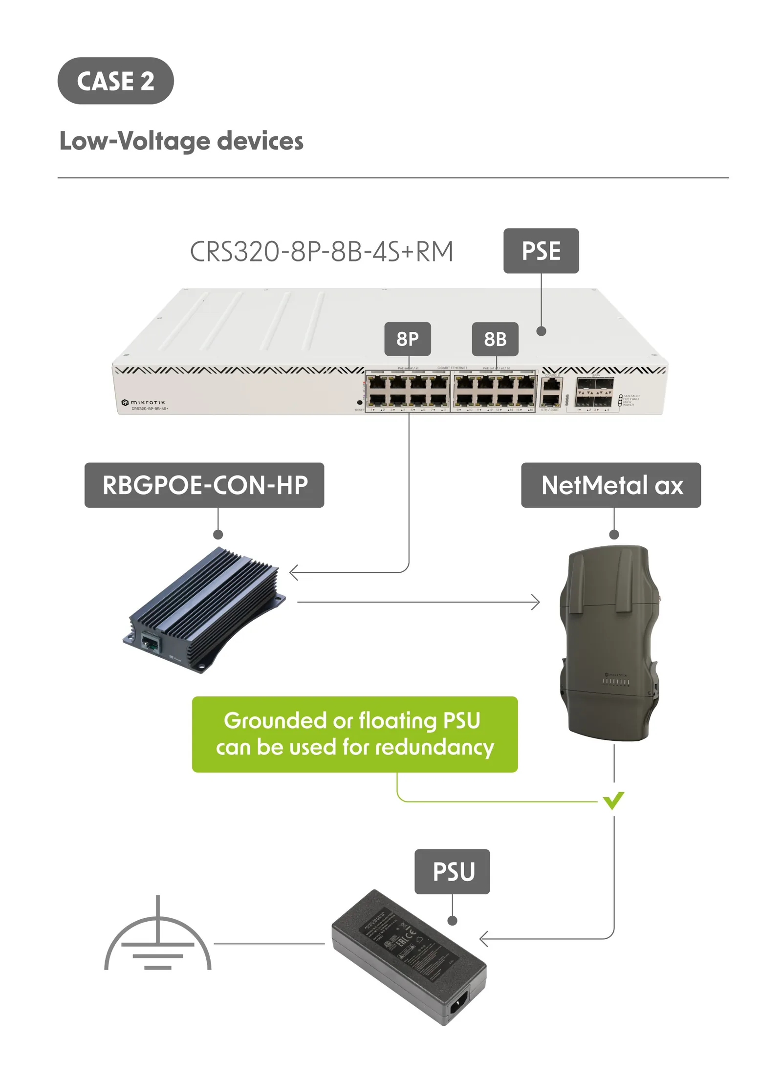

To power a Passive PoE device, the RBGPOE-CON-HP should be used. Grounded or floating PSU can be used for redundancy.
Use case 3 - Special cases for 802.3 af/at Powered Device with non-isolated PoE​
  • Any ground connection should be avoided.
  • If the ground connection is required, for a Powered Device with non-isolated PoE RBGPOE-CON-HP should be used.
  • Grounded PSU can't be used for Powered Devices at the same time.
  • An SFP cage, USB and RS232 ports should not have a connection to the ground.
