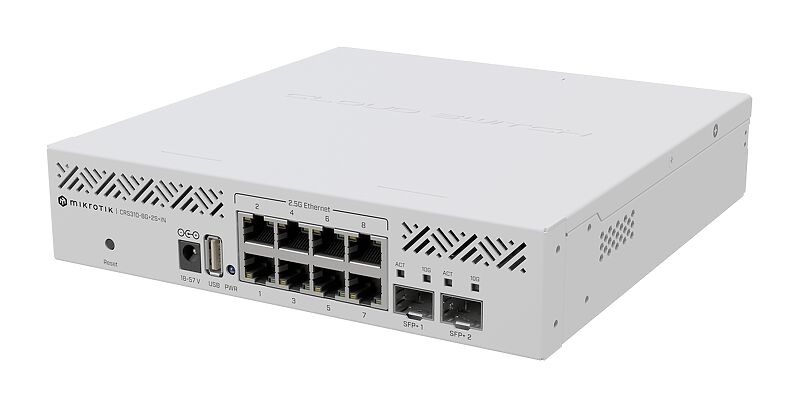

CRS310-8G+2S+IN
Take advantage of the blazing fast 2.5/10 Gigabit combo and upgrade your workspace! This switch can utilize the full potential of RouterOS v7: run VLANs, Jumbo frames, link aggregation, ACL rules, and so much more! See the CRS310-8G+2S+IN product page for full specifications and brochures.
