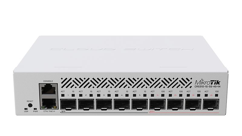

The device is designed to use indoors and it can be mounted in a rackmount enclosure using provided rack mounts, or it can be placed on the desktop. Please attach rubber pegs on the bottom of the router if the desired placement is on the flat surface or use a Phillips screwdriver to attach rackmount ears on both sides of the device if the designated use is for rackmount enclosure.
- Attach rack ears to both sides of the device and tighten four screws to secure them in place, as shown in the picture to the right.
- Place the device in a rackmount enclosure and align it with the holes so that the device fits conveniently.
- Tighten screws to secure it in place. The IP rating scale for this device is IPX0. The device has no protection from water contamination, please ensure the placement of the device in a dry and ventilated environment. We recommend shielded Cat5/6 cables for our devices. The mounting and configuration of this device should be done by a qualified person.

Full documentation for RouterOS is available at: https://mt.lv/help You can configure the device using WebFig in a web browser or the "WinBox" configuration tool https://mt.lv/winbox. Multiple configuration methods are available to ensure accessibility. **To start setup, open https://192.168.88.1 in a web browser to start setup. If the IP address is unavailable, use WinBox and choose the "Neighbors" tab to find the device. Proceed to connect using the MAC address. The username is "admin", and there is no password (or, for some models, check user and wireless passwords on the sticker). The device is equipped with an RJ45 serial port, set by default to 115200 bit/s, 8 data bits, 1 stop bit, no parity. For recovery purposes, it is possible to reinstall the device from the network, see the Reset button.
Marvell Prestera switch chip features.
Reset button
- To reset the configuration, unplug the device from power, press and hold the Reset button, and release it when the USER (USR) LED starts flashing.
- To load the backup bootloader, press and hold the Reset button before applying power, then release it after three seconds.
- To initiate the Netinstall process (booting the device in BOOTP mode to reinstall RouterOS), press and hold the Reset button, power on the device, and wait for the USER (USR) LED to flash, then become stable. When the USR LED turns off, release the Reset button. Regardless of the above option used, the system will load the backup RouterBOOT loader if the button is pressed before power is applied to the device. Useful for RouterBOOT debugging and recovery.
