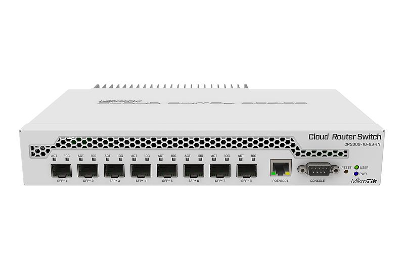

This device is a network switch with eight SFP+ ports and one-gigabit port. It is already configured, with all ports switched together. See the CRS309-1G-8S+IN product page for full specifications and brochures.

  • The port LEDs indicate the individual Ethernet and SFP port activity.

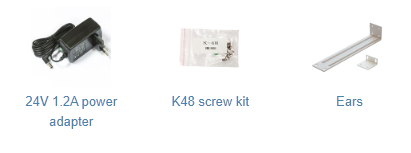

Package includes the following accessories that come with the device:
See the MikroTik wired interface compatibility table for supported SFP modules.
