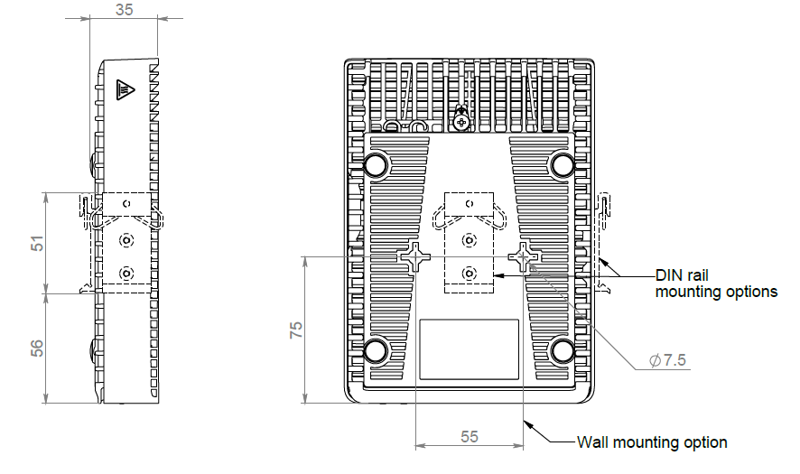

Mounting
This indoor switch offers multiple mounting options, including a side DIN rail mount and standard screw points on the back for easy integration. The DIN rail mount can also be repositioned to the back.

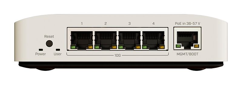

Extension slots and ports
  • Four 1G/2.5G/5G/10G Ethernet ports.
  • One Gigabit Ethernet port, suggested to be used for management (Supports Auto MDI/X so you can use either straight or cross-over cables for connecting to other network devices). The MGMT/BOOT Ethernet port can also be used for network booting and recovery with Netinstall.
Reset button
  • To reset the configuration, unplug the device from power, press and hold the Reset button, and release it when the USER (USR) LED starts flashing.
  • To load the backup bootloader, press and hold the Reset button before applying power, then release it after three seconds.
  • To initiate the Netinstall process (booting the device in BOOTP mode to reinstall RouterOS), press and hold the Reset button, power on the device, and wait for the USER (USR) LED to flash, then become stable. When the USR LED turns off, release the Reset button. Regardless of the above option used, the system will load the backup RouterBOOT loader if the button is pressed before power is applied to the device. Useful for RouterBOOT debugging and recovery.
