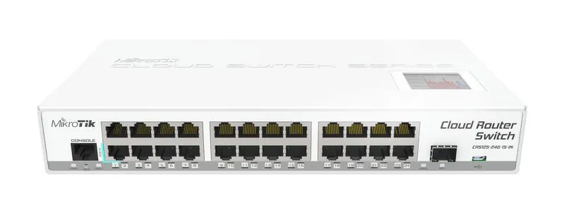

- Twenty four (24) 10/100/1000 (Gigabit) Ethernet ports (Auto MDI/X)
- CRS125 has one SFP cage, compatible with 1.25G SFP modules.
- CRS125-24G-1S-2HnD-IN has built-in 802.11b/g/n 2GHz wireless access point.
