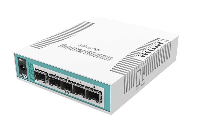

CRS106-1C-5S
The CRS106-1C-5S is a network switch with five SFP ports and one Ethernet/SFP combo port. It is already configured, with all ports switched together. We recommend you set up a password to secure your device. See the CRS106-1C-5S product page for full specifications and brochures.

The power consumption of this device under maximum load is up to 11 W. The device accepts powering in the following ways:
  • Direct-input power jack (5.5mm outside and 2mm inside, female, pin positive plug) accepts 8-30 V DC.
  • The combo ethernet port accepts passive Power over Ethernet 8-30 V DC, PoE injector is not included.
Setup​
The device has five SFP ports and one SFP/Ethernet combo port. This unit is compatible with 100Mbit and 1.25G SFP modules. The ETH/SFP combo interface has two connectors on the back of the unit, of which only one can be used at the same time, the used port will be automatically recognized as Combo1. It is possible to select which physical port will be used in the software ethernet menu. If left to default "auto", first to initialize will be used.
First use​
  • Connect your WAN cable to port 1, and the other devices to ports 2-5.
  • Set client device IP configuration to automatic (DHCP).
  • The default IP address from ports 2-5 (LAN) is 192.168.88.1.
  • Username is admin, there is no password (or, for some models, check user and wireless passwords on the sticker).
  • Secure the device by setting up a password.
