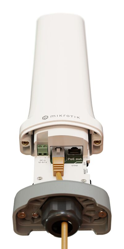

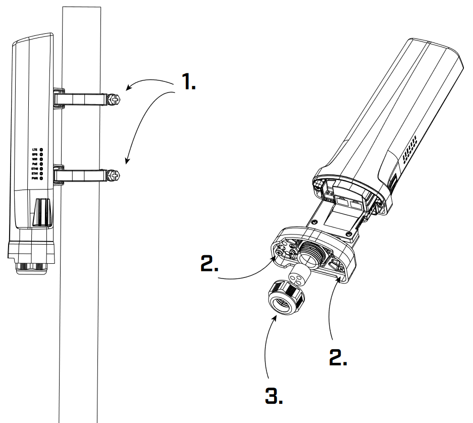

Mounting and bottom lid​
  • The backside of the device has 2 holes, where you can input the metal ring.
  • Unscrew the metal ring to loosen it, put one end of the metal ring into the hole and wrap the ring around the pole or a mast, then screw the metal ring to tighten it up - see. 1.
  • Unscrew the two screws under the bottom lid. When they are loose, slightly pull down the bottom lid to open access to Ethernet ports, SIM slot and reset button - see. 2.

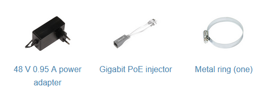

Accessories​
The package includes the following accessories that come with the device:
