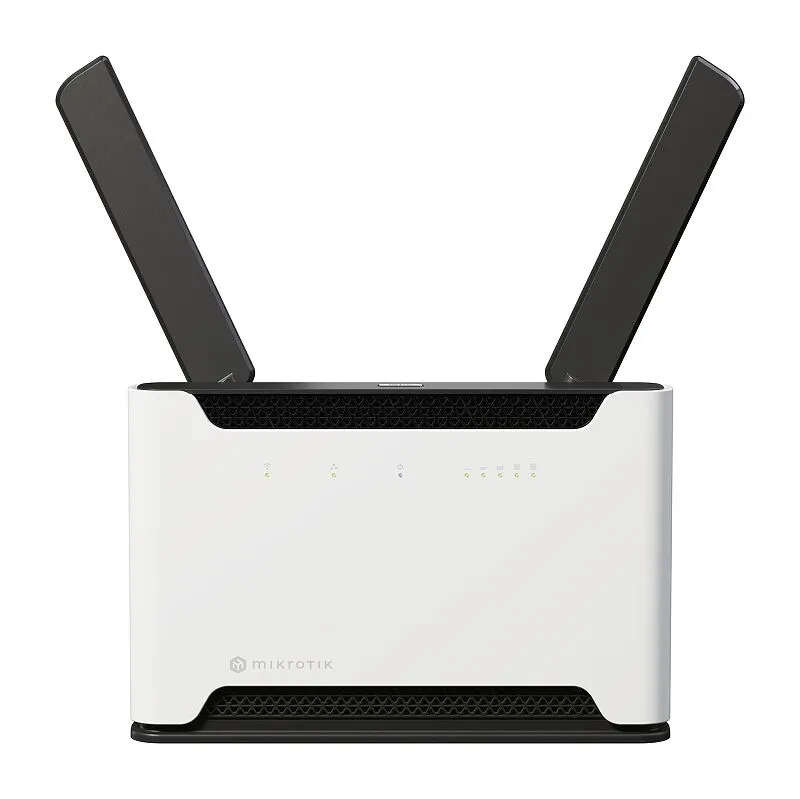

Front LED status
  • Wireless network activity.
  • Ethernet port activity.
  • System LED.
  • Signal strength. Cellular connection technology based on the System LED color: Red: GSM Yellow: 3G Blue: LTE Green: 5G NSA Violet: 5G SA
When LTE is not connected to the network, the system LED will blink red to indicate that there is some issue with the LTE connection. If the LTE interface is intentionally disabled (not being used), the system LED will glow blue.
