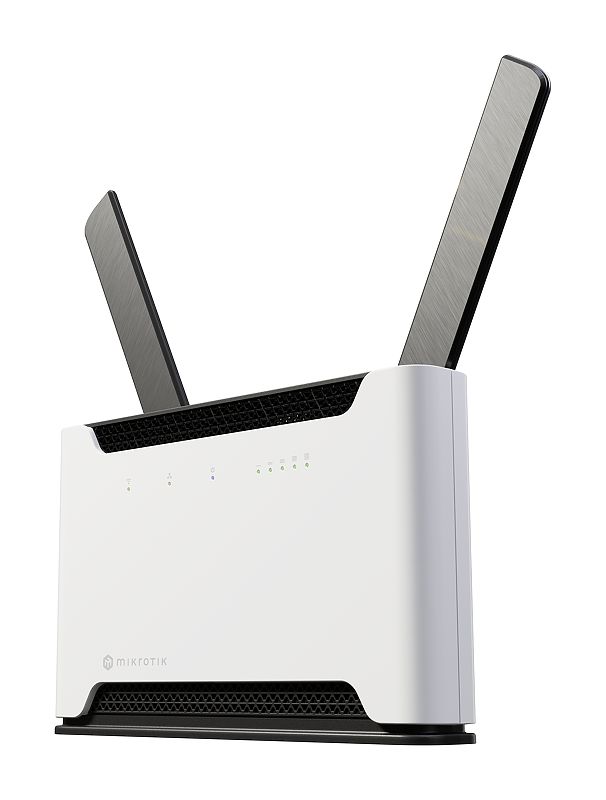

Chateau LTE18 ax (S53UG+5HaxD2HaxD-TC&EG18-EA)​
The best home AP just got even better. Generation 6 version of the Chateau LTE18. Much faster wireless, improved CPU, and now – with 2.5 Gigabit Ethernet! See the Chateau LTE18 ax product page for full specifications and brochures.

Extension slots and ports​
  • Reset button.
  • Powering DC jack 2.0 mm.
  • Five Gigabit ports, supporting automatic cross/straight cable correction (Auto MDI/X). Either straight or crossover cables can be used for connecting to other network devices.
  • USB type-A.
  • SIM slot for Micro sim card.
  • Mode button.
  • A cover for an external SMA antenna connector is not provided for models with antennas.
  • WPS Sync button.
  • Product code S53UG+5HaxD2HaxD-TC&EG18-EA.
  • CPU Quad-Core IPQ-6010 1.8 GHz.
  • CPU architecture ARM 64bit.
  • Size of RAM 1 GB.
  • RAM type DDR3L.
  • Storage 128 MB, NAND.
  • A number of 1G Ethernet ports 4.
  • A number of 2.5G Ethernet ports 1.
  • Micro SIM slots 1.
  • USB 1 USB 3.0 type A.
  • Switch chip model IPQ-6010.
  • Wireless interface model QCN-5022 (2.4 GHz), QCN-5052 (5 GHz).
  • Wireless 2.4 GHz 802.11ax dual-chain, 5 GHz 802.11ax dual-chain.
  • Wireless antenna max gain 2.4 GHz (3 dBi), 5 GHz (6 dBi).
  • LTE category 18 (1.2Gbps Downlink, 150Mbps Uplink).
  • LTE modem EG18-EA.
  • TAC 86981604.
  • LTE antenna gain 4 dBi.
  • LTE FDD bands 1 (2100MHz) / 3 (1800MHz) / 5 (850MHz) / 7 (2600MHz) / 8 (900 MHz) / 20 (800MHz) / 28 (700MHz).
  • LTE TDD bands 38 (2600MHz) / 40 (2300MHz) / 41 (2500MHz).
  • 3G Category R8 (42.2Mbps Downlink, 11.2Mbps Uplink).
  • 3G Bands 1 (2100MHz) / 3 (1800MHz) / 5 (850MHz) / 8 (900MHz).
  • Dimensions 240 x 156 x 44 mm.
  • Operating system RouterOS v7, License level 4.
  • Operating temperature -40°C to +65°C.
