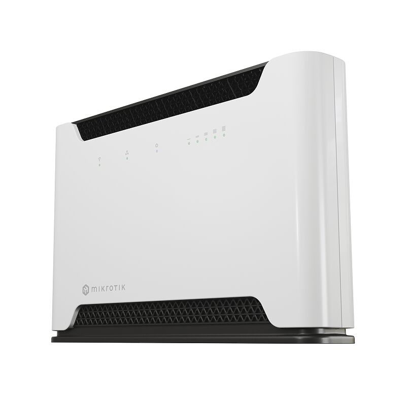

Front LED status​
  • Wireless network activity.
  • Ethernet port activity.
  • System LED with alternate mode for cellular modem status indication.
  • Modem signal strength indicators.
