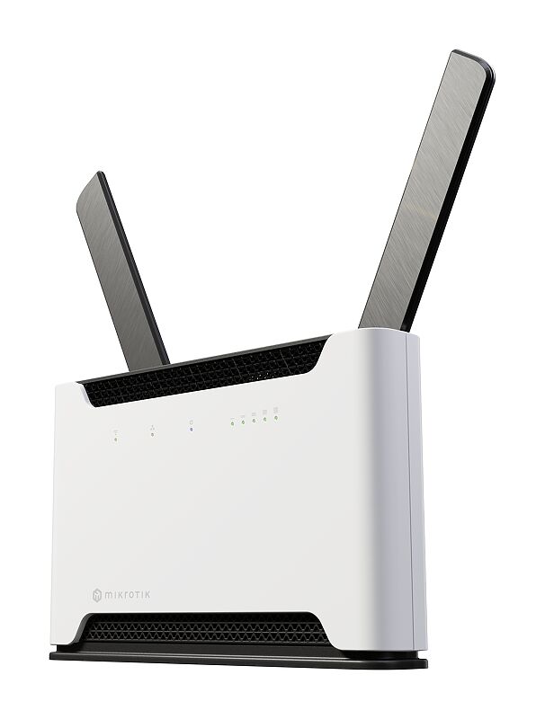

Chateau 5G R17 ax
Chateau 5G R17 ax (S53UG+5HaxD2HaxD-TC&RG650E-EU)​

  • Product code: S53UG+5HaxD2HaxD-TC&RG650E-EU.

  • Dimensions: 240 x 156 x 44 mm.
