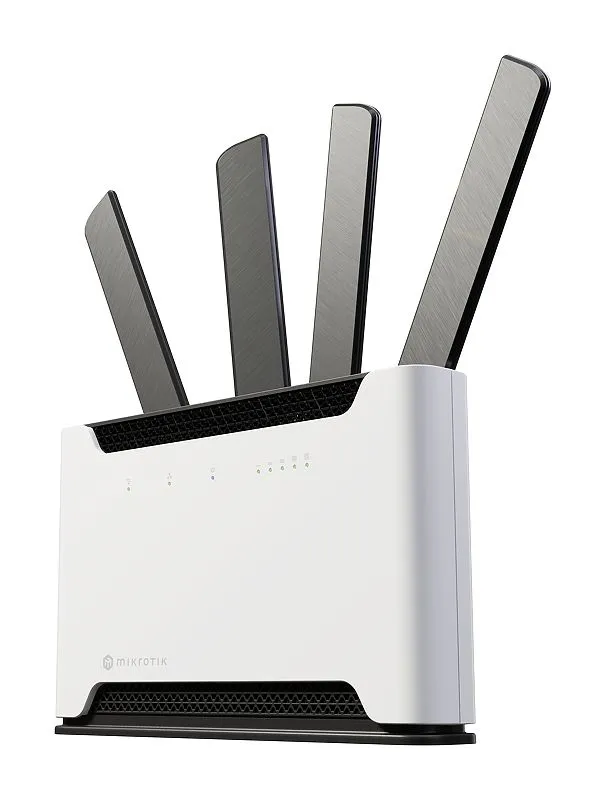

Chateau 5G ax
Chateau 5G ax (S53UG+M-5HaxD2HaxD-TC&RG502Q-EA)

Quickstart
follow these quick steps to set up your device:
- Connect external antennas to the SMA connector (The antennas are provided in the package, see "(link)");
- Insert a micro SIM card into the slot located under the device;
- Connect your computer to one of the Ethernet ports;
- Connect the power adapter to the DC jack;
- Once the device is powered on and the PC is connected to the device, open https://192.168.88.1 in your web browser to start the configuration (or, for some models, check user and wireless passwords on the sticker);
- User name: admin, find the password on the sticker;
- You should select the "Check for updates" button on the right side and update your RouterOS software to the latest version to ensure the best performance and stability, Must have a valid SIM card inserted;
- For a manual update of the device, visit the products page at https://mikrotik.com/products to find your product. The required packages are accessible under the "Support&Downloads" menu;
- Upload downloaded packages to the (WebFig) (Files) menu and reboot the device;
- Updating your RouterOS software to the latest version will ensure the best performance, stability, and security updates;
- To personalize your wireless network, SSID can be changed in the fields "Network Name";
- Choose your country on the left side of the screen in the field "Country", to apply country regulation settings;
- Set up your wireless network password in the field "WiFi Password" the password must be at least eight symbols;
- Set up your router password in the bottom field "Password" to the right and repeat it in the field "Confirm Password", it will be used to log in next time;
- Select the "Apply Configuration" to save changes.
Connecting with a mobile app
Use your smartphone to access your router through WiFi.
- Insert the SIM card and power on the device.
- Scan the QR code and choose your preferred OS.
- Install and open the application.
- Select Connect to establish a connection to your device through a wireless network (check the wireless passwords on the sticker).
- The username is "admin" and there is no password (or, for some models, check user and wireless passwords on the sticker).
- Choose Quick Setup and the application will guide you through all basic configuration settings in a couple of easy steps.
- An advanced menu is available to fully configure all necessary settings.
Extension slots and ports
- (link)DC jack 2.0 mm.
- Five Gigabit ports, supporting automatic cross/straight cable correction (Auto MDI/X). Either straight or crossover cable can be used for connecting to other network devices.
- USB type-A.
- (link) for Micro sim card.
- Mode button.
- Cover for external (link) is not provided for models with antennas.
- WPS (link)
- Product code S53UG+M-5HaxD2HaxD-TC&RG502Q-EA.
- CPU Quad-Core IPQ-6010 1.8 GHz.
- CPU architecture ARM 64bit.
- Size of RAM 1 GB.
- RAM type DDR3L.
- Storage 128 MB, NAND.
- A number of 1G Ethernet ports 4.
- A number of 2.5G Ethernet ports 1.
- Micro SIM slots 1.
- USB 1 USB 3.0 type A.
- A number of M.2 slots 1.
- Switch chip model IPQ-6010.
- Wireless interface model QCN-5022 (2.4 GHz), QCN-5052 (5 GHz).
- Wireless 2.4 GHz 802.11ax dual-chain, 5 GHz 802.11ax dual-chain.
- LTE category 20 (2.0 Gbps Downlink, 200 Mbps Uplink).
- LTE modem R11mL-RG502Q-EA.
- TAC 86073604.
- 5G SA Category 4.2 Gbps Downlink, 900 Mbps Uplink.
- 5G NSA Category 5.0 Gbps Downlink, 650 Mbps Uplink.
- 3G Category R8 (42.2Mbps Downlink, 5.76Mbps Uplink).
- MIMO DL 4x4 (5G SA FDD), 4x4 (5G NSA FDD), 4x4 (LTE FDD).
- MIMO UL 2x2 (5G SA FDD), 1x1 (5G NSA FDD), 1x1 (LTE FDD).
- 5G SA FDD bands 1 (2100MHz) / 3 (1800MHz) / 5 (850MHz) / 7 (2600MHz) / 8 (900 MHz) / 20 (800 MHz) / 28 (700 MHz).
- 5G SA TDD bands 38 (2600MHz) / 40 (2300MHz) / 41 (2500MHz) / 77 (3700 MHz) / 78 (3500 MHz) / 79 (4700 MHz).
- 5G NSA FDD bands 1 (2100MHz) / 3 (1800MHz) / 5 (850MHz) / 7 (2600MHz) / 8 (900 MHz) / 20 (800 MHz) / 28 (700 MHz).
- 5G NSA TDD bands 38 (2600MHz) / 40 (2300MHz) / 41 (2500MHz) / 77 (3700 MHz) / 78 (3500 MHz) / 79 (4700 MHz).
- LTE FDD bands 1 (2100MHz) / 3 (1800MHz) / 5 (850MHz) / 7 (2600MHz) / 8 (900 MHz) / 18 (800 MHz) / 19 (800 MHz) / 20 (800 MHz) / 26 (850MHz) / 28 (700 MHz) / 32 (1500 MHz).
- LTE TDD bands 34 (2000 MHz) / 38 (2600MHz) / 39 (1900MHz) / 40 (2300MHz) / 41 (2500MHz) / 42 (3500MHz) / 43 (3700MHz).
- 3G bands 1 (2100MHz) / 3 (1800MHz) / 5 (850MHz) / 6 (850 MHz) / 8 (900MHz) / 19 (800 MHz).
- Dimensions 240 x 156 x 44 mm.
- Operating system RouterOS v7, License level 4.
- Operating temperature -40°C to +70°C.
