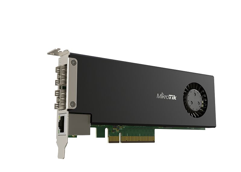

CCR2004-1G-2XS-PCIe
CCR2004-1G-2XS-PCIe​
A smart PCIe network interface card that adds full-fledged router capabilities to your servers. The smart and easy way to create 25 Gigabit networks if you want to save space in your server room! See the CCR2004-1G-2XS-PCIe product page for full specifications and brochures.

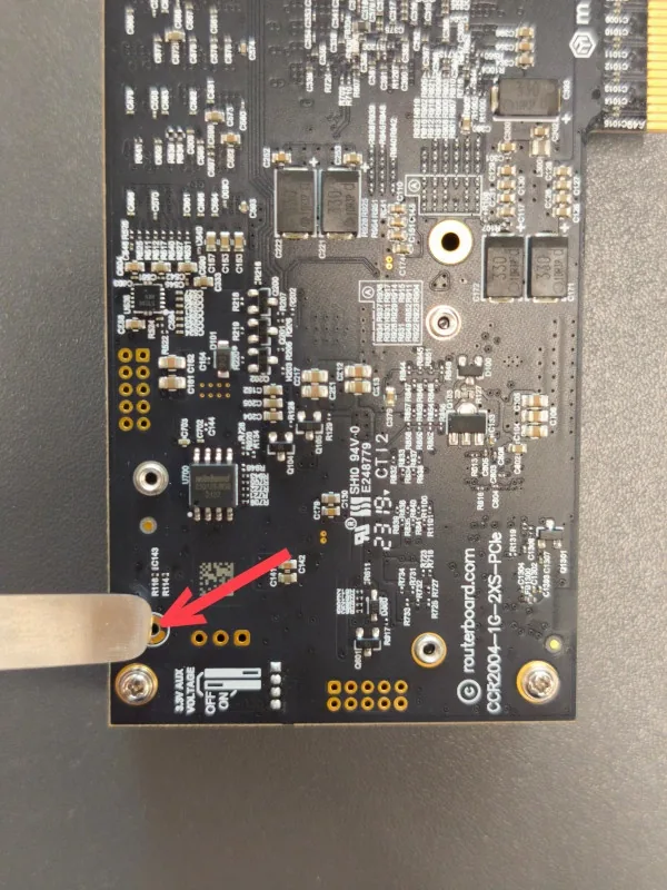

Reset​
To reset this device to factory settings you must turn off your PC.
  • Place a metal object into the reset hole so that it makes contact with both metalized sides.
  • Turn on the PC and hold the screwdriver until both 25G SFP28 LEDs starts flashing RED and then release it, it will reset the RouterOS configuration.
  • If you Keep holding for more than 5 seconds up to 20 seconds until the red LEDs turns off, it to make the RouterBOARD look for Netinstall servers.
