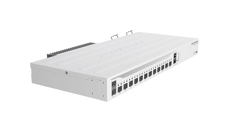

The CCR2004-1G-12S+2XS is a high-performance multicore router with twelve 10G SFP+ ports and two 25G SFP28 ports. See the CCR2004-1G-12S+2XS product page for full specifications and brochures.

The device is designed to use indoors and it can be mounted in a rackmount enclosure using provided rack mounts, or it can be placed on the desktop. Use a Phillips screwdriver to attach rackmount ears on both sides of the device if designated use is for rackmount enclosure:
  • Attach rack ears to both sides of the device and tighten four screws to secure them in place, as shown on the picture to the right;
  • Place the device in rackmount enclosure and align with the holes so that the device fits conveniently;
  • Tighten screws to secure it in place. The device has no protection from water contamination, please ensure the placement of the device in a dry and ventilated environment. We recommend Cat6 cables for our devices.
