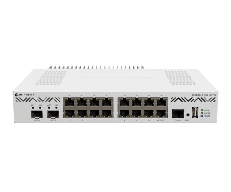

Up to 300% faster than the previous CCR1009 routers - in a blissful silence! Luxury you deserve for the price you can afford. 16x Gigabit Ethernet ports, 2x10G SFP+ cages. See the CCR2004-16G-2S+PC product page for full specifications and brochures.

  • Connect your PC to the MGMT/BOOT labeled port or the first Ethernet port;

The Ethernet port 15 has a default IP address for connecting: 192.168.88.1. The username is admin and there is no password. The device doesn't have any other configuration applied by default, please set up WAN IP addresses, user passwords, and update the device. RouterOS includes many configuration options in addition to what is described in this document. We suggest starting here to get yourself accustomed to the possibilities: https://mt.lv/help In case the IP connection is not available, the WinBox tool (https://mt.lv/winbox) can be used to connect to the MAC address of the device from the LAN side For recovery purposes, it is possible to boot the device for reinstallation, see the Reset button.

  • Product code CCR2004-16G-2S+PC
  • CPU AL32400 1.2 GHz
  • CPU architecture ARM 64bit
  • CPU core count 4
  • Size of RAM 4 GB
  • RAM type DDR4
  • Storage 128 MB, NAND
  • Number of 1G Ethernet ports 16
  • Number of 10G SFP+ ports 2
  • Operating system RouterOS v7, License level 6
  • Switch chip model 88E6191X
  • Number of Gbit ports in switch 8
  • Dimensions 272 x 195 x 44 mm
  • Operating temperature -20°C to +60°C
