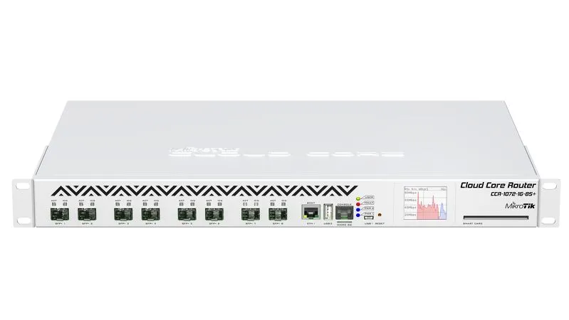

The CCR1072-1G-8S+ is a high-performance multicore router with eight SFP+ cages. Ports are directly connected to a Tilera 72 core CPU and assisted by 16 GB of built-in ECC RAM. See the CCR1072-1G-8S+ product page for full specifications and brochures.

  • 1 Gigabit Ethernet port.
  • 8 SFP+ ports for 10 Gigabit connectivity.
  • USB slot type A.
  • microUSB slot type AB.
  • Automatic fan speed control.The CCR1072 has PCIe Gen 2.0 x4 connections to the two M.2 slots.Recommended are NVMe M.2 2280mm M key SSD disks with a capacity of up to 1TB.
