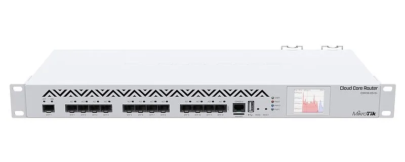

The device is designed to use indoors and it can be mounted in a rackmount enclosure using provided rack mounts, or it can be placed on the desktop. Use a Phillips screwdriver to attach rackmount ears on both sides of the device if designated use is for rackmount enclosure:
  • Attach rack ears to both sides of the device and tighten four screws to secure them in place, as shown in the picture.
  • Place the device in a rackmount enclosure and align with the holes so that the device fits conveniently.
  • Tighten screws to secure it in place. The device has no protection from water contamination, please ensure the placement of the device in a dry and ventilated environment. We recommend shielded Cat5/6 cables for our devices. Mounting and configuration of this device should be done by a qualified person.
