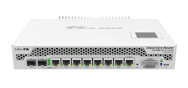

Cloud Core Router - Fully independent Ethernet ports each with a direct connection to the CPU. See the CCR1009-7G-1C-1S+PC product page for full specifications and brochures.
