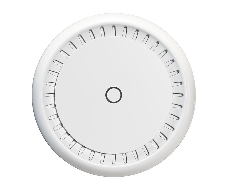

cAP XL ac (RBcAPGi-5acD2nD-XL)​
The ceiling AP on steroids! Our bestseller cAP is back – juiced up and stronger than ever. Compared to the previous cAP models, the improved high-gain antenna increases the covered area by up to 100%! See the cAP XL ac product page for full specifications and brochures.

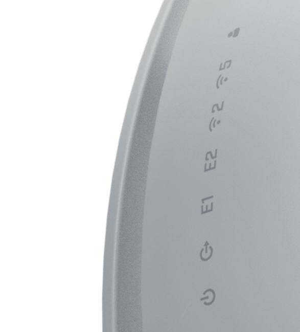

LED indicators​
There are seven LED lights on the unit, which can be disabled altogether if necessary.
  • User – user-configurable led for any desired script.
  • 5G – 5GHz interface activity.
  • 2G – 2.4 GHz interface activity.
  • E2 – Ethernet 2 connected.
  • E1 – Ethernet 1 connected.
  • PoE LED indicates that the ETH2 port is currently powering another device with PoE.
  • The power LED indicates that the unit is receiving power in the ETH1 port.
