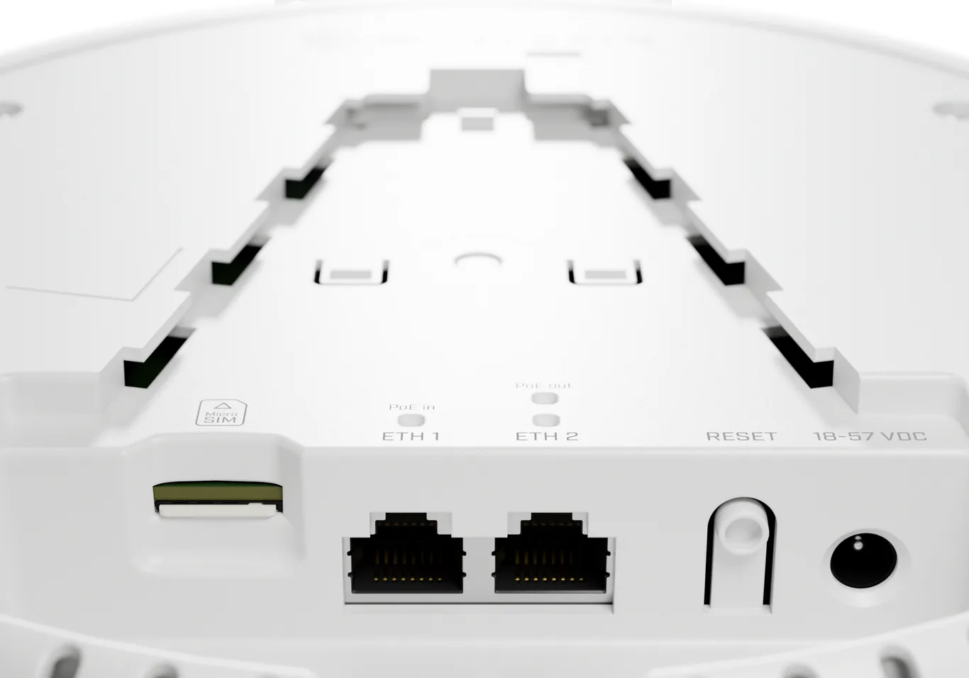

  • Connect the device to the included PoE injector with an Ethernet cable to the "data+power" end;
  • Connect to the device through either one of the Ethernet ports or the wireless network "MikroTik-..." (ensure to check the wireless passwords on the sticker);

  • Number of DC inputs: 2 (DC jack, PoE-IN);
  • Supported input voltage 18-57 V (DC jack) 18-57 (PoE-In)
  • PoE-in 802.3af/at: Ether1;
  • PoE-Out Passive PoE up to 57V (<30v DC jack must be used, >30V PoE-In and DC jack can be used)
  • PoE-Out port: Ether2, max out per port output (input < 30 V): 0.6 A, max out per port output (input > 30 V): 0.4 A. Over 0.3 A current, use a DC jack for powering the device.
  • Max power consumption (without attachments) 13 W
  • Max power consumption 34 W

Reset button​
The reset button has three functions:
  • Hold this button during boot time until the LED light starts flashing, and release the button to reset the RouterOS configuration (total 5 seconds).
  • Keep holding for 5 more seconds, the LED turns solid, release now to turn on CAP mode. The device will now look for a CAPsMAN server (total 10 seconds).
  • Or Keep holding the button for 5 more seconds until the LED turns off, then release it to make the RouterBOARD look for Netinstall servers (total 15 seconds). Regardless of the above option used, the system will load the backup RouterBOOT loader if the button is pressed before power is applied to the device. Useful for RouterBOOT debugging and recovery.
