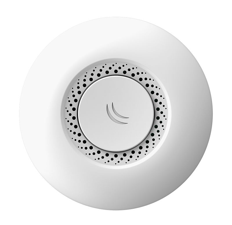

cAP (RBcAP2nD)​
The cAP is a small AP device with one Ethernet port, it supports powering by PoE and optionally can be managed by the CAPsMAN management server. See the cAP product page for full specifications and brochures.

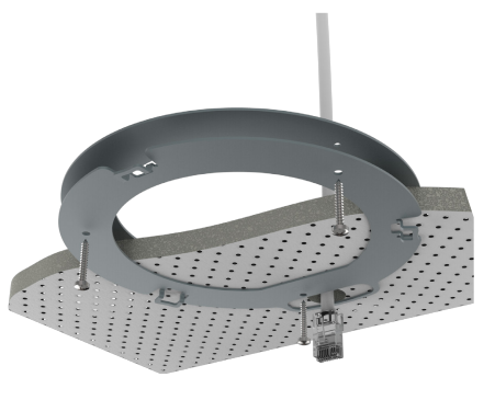

Mounting​
It is possible to attach the device to a wall or ceiling, using the provided mounting bracket on the back of the unit.
  • Attach the mounting bracket to the wall or ceiling with provided three screws.
  • Use a 5 mm drill bid if necessary with provided dowels.
  • Connect needed cables to the device.
  • If needed second mounting bracket can be used for additional support when working on thin ceilings or walls, provided screw length is 20 mm.
  • Attach the second mount to the other side of the ceiling and secure with screws through the first mount.
  • Attach the device to the mounting bracket and turn clockwise until the device secures in place. We recommend using Cat5/6 cable for our devices. The IP rating scale for this device is IPX0. Mounting and configuration of this device should be done by a qualified person. Warning! This equipment should be installed and operated with a minimum distance of 20 cm between the device and your body. Operation of this equipment in the residential environment could cause radio interference.
