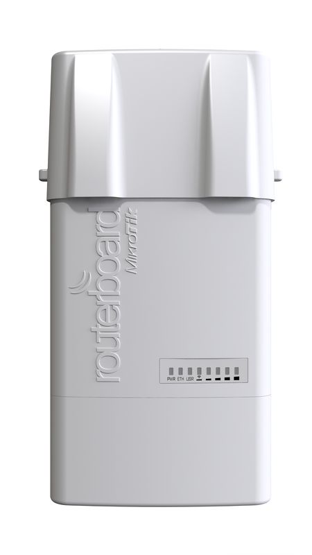

BaseBox 5 (RB912UAG-5HPnD-OUT)​
This article covers

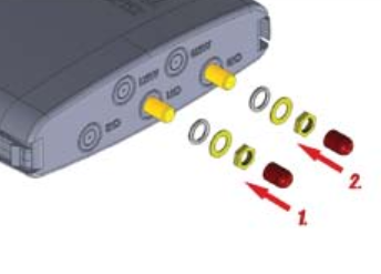

The Basebox is a solid and weatherproof outdoor device based on the RB912 wireless router model. It has high power wireless and one Gigabit Ethernet connector, which supports MDI-X auto-detection. The device has two RPSMA connectors for connecting external antennas. The device is packaged with a power adapter, a PoE injector, and two mounting loops. Extra places for more RP-SMA connectors are available on the unit in this case.

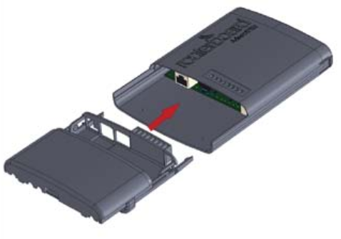

The miniPCI-e slot usage​
  • Remove top cover;

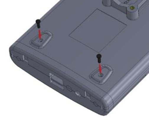

  • Unscrew two screws on the back of the device;
  • Open Ethernet port cover and withdraw it from the base of the device;
  • Unscrew the antenna connector;
  • Withdraw the PCB plate from the base cover;
  • Install your modem and reassemble.
