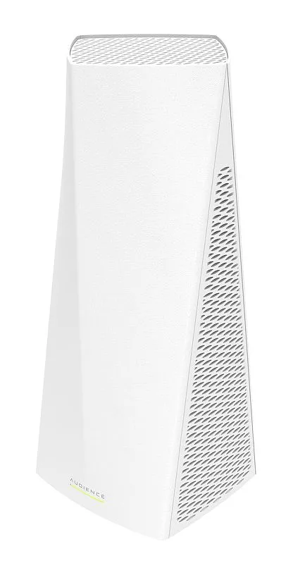

Audience LTE6 kit (RBD25GR-5HPacQD2HPnD&R11e-LTE6)​
The Audience LTE6 kit is a home access point with a built-in LTE modem. You can extend the wireless coverage by adding more Audience devices to the network — they form a single network with the same SSID, so your devices can roam freely within its range.
