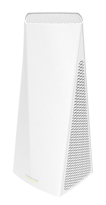

Audience (RBD25G-5HPacQD2HPnD)​
Audience - home access point for reliable network build. Easy to outspread wireless network coverage by adding more Audience devices to it. You will be able to move with your wireless appliance within network range and Audience devices will bond the same (SSID) with it. See the Audience product page for full specifications and brochures.

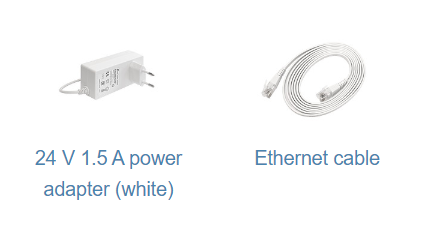

Accessories​
