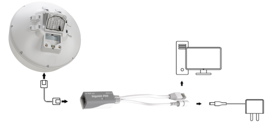

Quickstart​
  • Open the Ethernet port door;
  • Insert the Micro SIM card into the slot with the chip facing up; if you want to use eSIM, read the eSIM section;
  • Connect the device to the included PoE injector with an Ethernet cable to the data+power end;
  • Connect the data end of the PoE injector to the computer;
  • Connect the power adapter to the PoE injector;
  • Configure your device using a web browser through WebFig or the WinBox tool at https://mt.lv/winbox. Multiple configuration methods are available to ensure accessibility;
  • Access WebFig by opening https://192.168.188.1, and for WinBox, download the tool, navigate to the Neighbors tab, and select the MAC address. The username is "admin" with no password (or, for some models, check user and wireless passwords on the sticker);
  • Select the "Check for updates" button and update RouterOS to the latest version. A valid SIM card must be inserted or an eSIM must be set up, and an active Internet connection is required.
  • For a manual update of the device, visit the products page at https://mikrotik.com/products to find your product. The required packages are accessible under the "Support&Downloads" menu;
  • Set up your router password.
