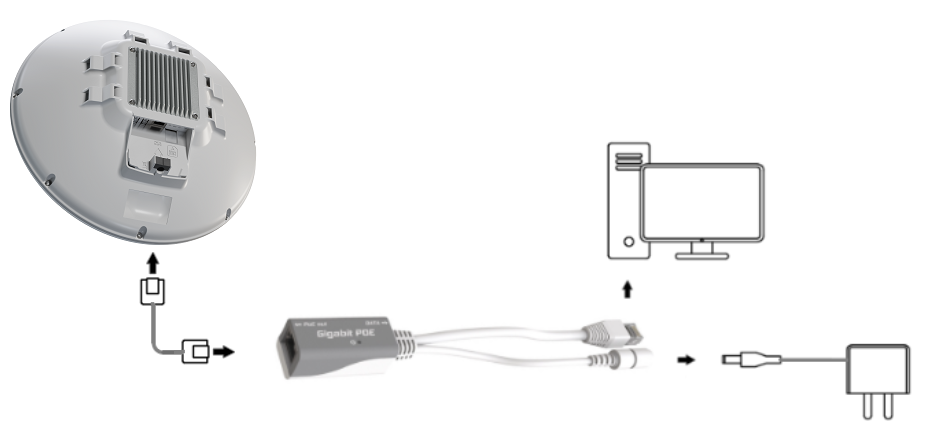

- Open the Ethernet port door;
- Insert the SIM card into the slot, with the chip facing UP;
- Connect the device to the included PoE injector with an Ethernet cable to the data+power end;
- Connect the data end of the PoE injector to the computer;
- Connect the power adapter to the PoE injector;

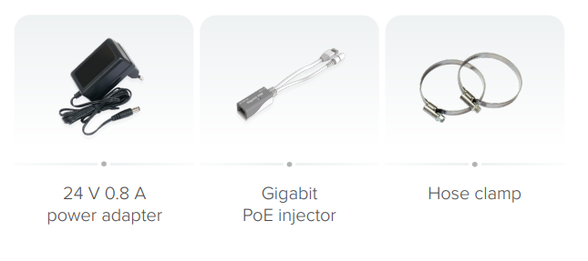

The package includes the following accessories that come with the device:
