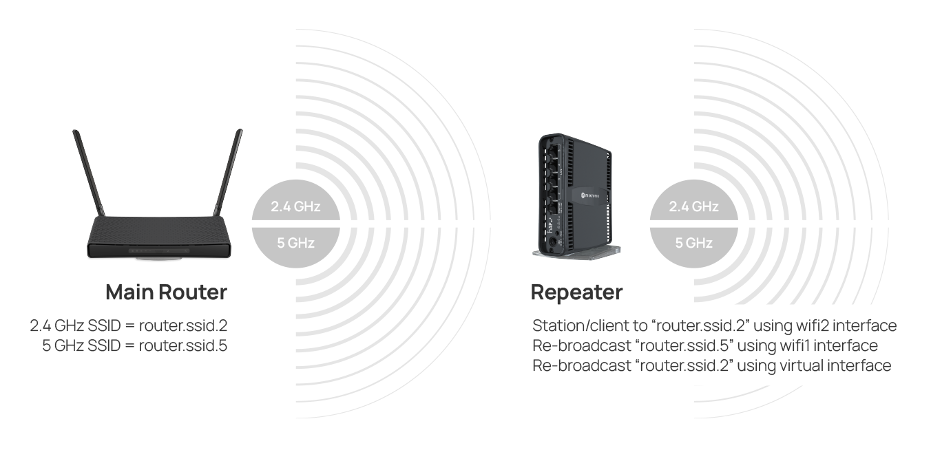

Dual-band routers and access points, from the get-go, should have two Wi-Fi interfaces → wifi1 and wifi2, each representing a certain frequency, 5 and 2.4 GHz respectively. For repeater setup, one of the interfaces needs to be turned into a station interface (which will act as a client to another network), while, the other, should be set in ap mode (which will allow the device to broadcast its own network).
If we use 2.4 GHz as a station interface, it would increase the distance at which we can install the repeater, but it would also reduce the throughput we can get from it. If we use 5 GHz as a station interface, we reduce the range but increase the throughput.
warning
Because we will be changing Wi-Fi and port-related configurations, it is advised to connect to the device's settings via Ethernet port/cable, using the MAC address. You can use the Winbox "Neighbors" tab and double-click on the MAC address of the device in the list. This way, you will not lose access later on when changing interface-related settings.
In our example, we want to use wifi2 (2.4 GHz) as a "station" interface, while having wifi1 (5 GHz) broadcast repeater's own SSID (and also, potentially re-broadcast router's SSID over 2.4 GHz as well):
Overall configuration:
/interface/wifi
set [ find default-name=wifi2 ] configuration.mode=station-bridge configuration.country=Latvia .ssid=router.ssid.2 disabled=no security.authentication-types=wpa2-psk .passphrase=router.password
set [ find default-name=wifi1 ] configuration.mode=ap configuration.country=Latvia .ssid=router.ssid.5 disabled=no security.authentication-types=wpa2-psk .passphrase=router.password
add configuration.mode=ap .ssid=router.ssid.2 disabled=no master-interface=wifi2 name=wifi3 security.authentication-types=wpa2-psk .passphrase=router.password

2.4 GHz interface configuration​
/interface/wifi
set [ find default-name=wifi2 ] configuration.mode=station-bridge .ssid=router.ssid.2 disabled=no security.authentication-types=wpa2-psk .passphrase=router.password

5 GHz interface configuration​
/interface/wifi

Optional step - adding virtual interface​
In case you want to make the extender re-broadcast wireless networks using both frequencies (e.g. wifi2 is reserved for mode=station-bridge, and you are left only with wifi1 for mode=ap), create a virtual interface on top of the station interface:
/interface/wifi
