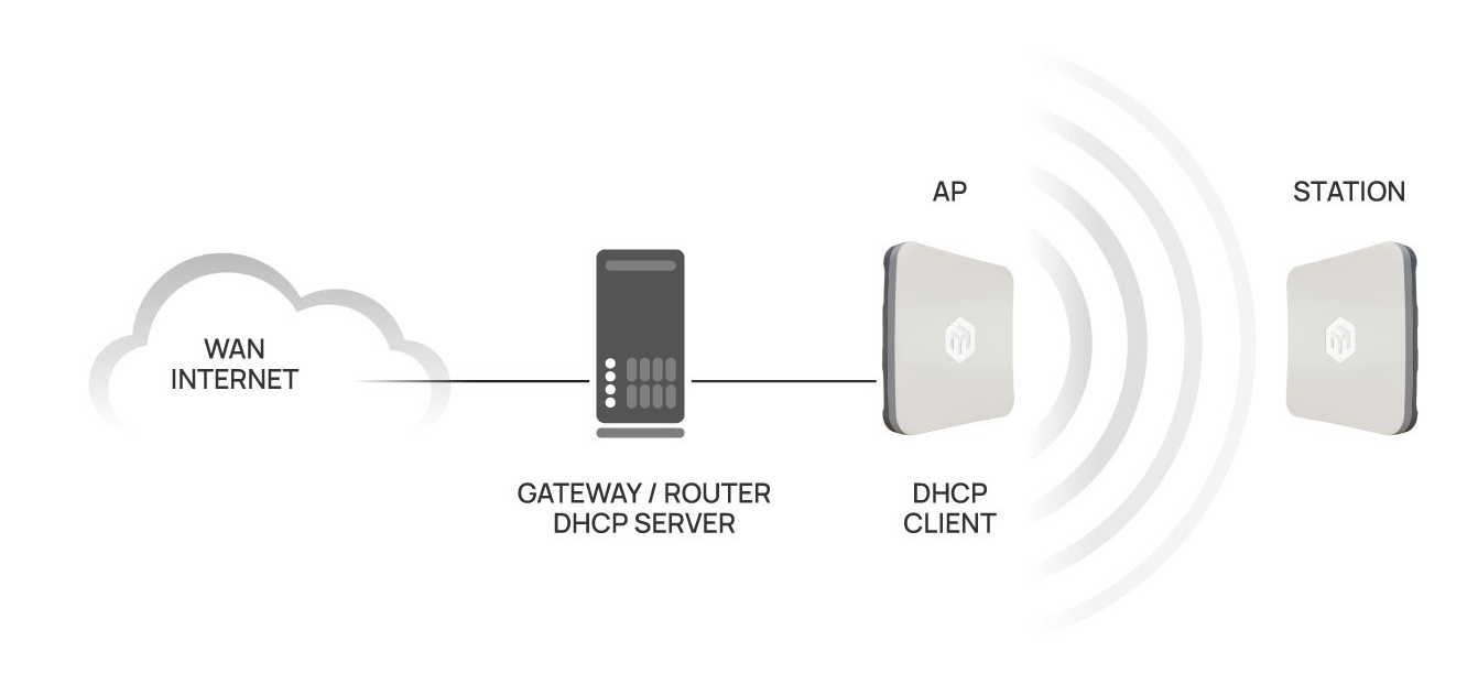

Scenario #1​
In case you already have a DHCP-server in the topology that is responsible for providing IP addresses to the network, and you want to install the AP behind it:
  1. Ensure that the AP has a bridge interface added and that all Ethernet and WiFi ports are a part of it.
  2. Set up DHCP-client on that bridge or, statically, add an IP address and a default route, instead.
  3. Change interface list members roles if required.

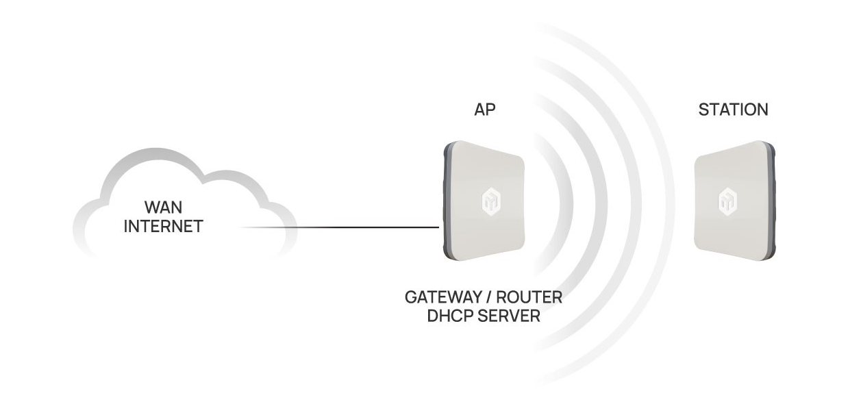

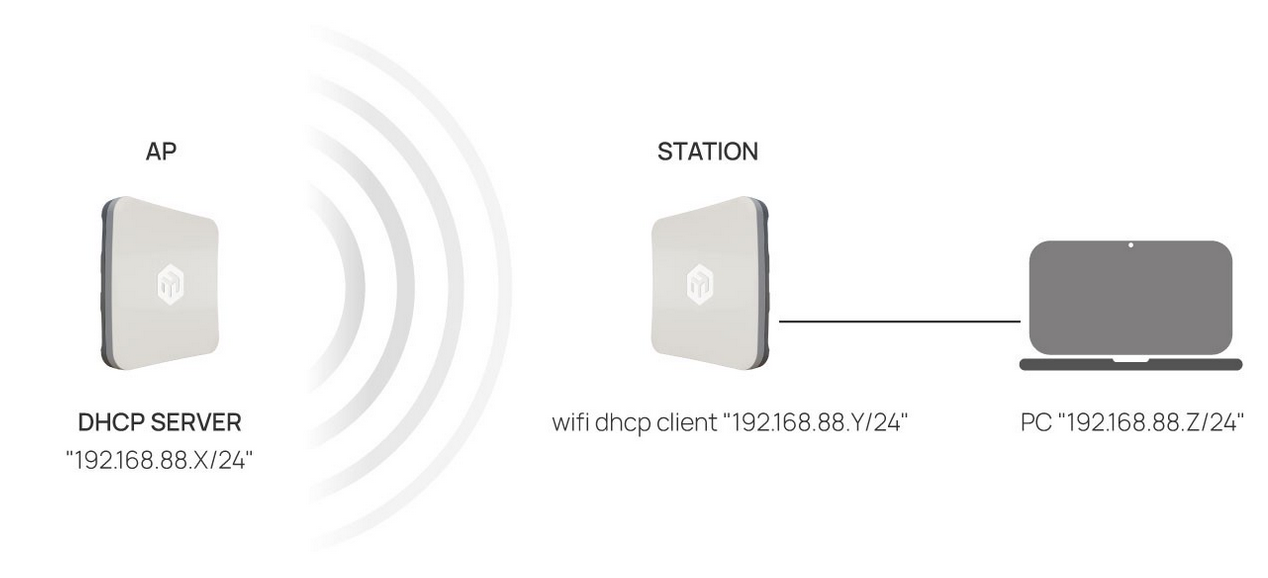

Scenario #2​
In case you want to have the AP itself act as a DHCP-server for stations:
  1. Configure an ethernet port as an uplink/WAN port, i.e. set up a DHCP-client or static IP for the ethernet interface, set up a default route and categorize the port as a "WAN" port in the interface list settings.
  2. Set up a DHCP-server on top of the WiFi interface (or on top of the bridge, which WiFi port is a part of) and add a respective IP address to that interface.

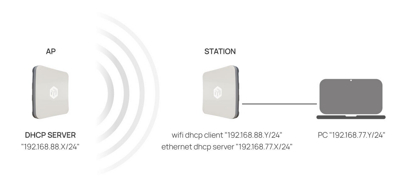

Scenario #1​
Scenario where station's WiFi interface is categorized as a "WAN" interface, which allows station's clients to stay hidden behind NAT. This is a factory configuration applied to most CPE devices.
An example of such a topology:
This type of setup requires the CPE to have:
  1. The WiFi interface categorized as "WAN" port in the interface list members menu.
  2. a DHCP-server running on the "other/ethernet" interfaces (it is suggested to ensure that AP's DHCP server and Station's DHCP server networks do not use the same subnet, as it can lead to layer3/routing issues).
  3. a DHCP-client or a static IP applied to the WiFi interface and a default route configured.
  4. mode=station configured in the WiFi settings.
