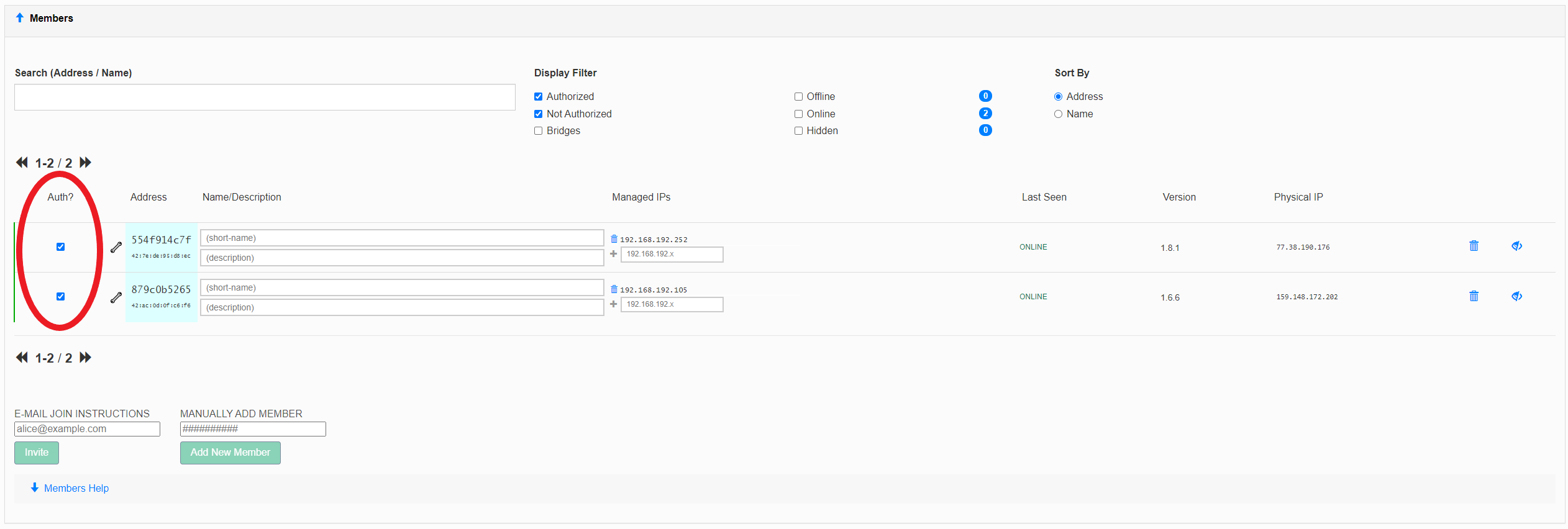

Install a ZeroTier client on your smartphone or computer, follow the ZeroTier manual on how to connect to the same network from there.
If **"**Access Control" is set to "Private", you must authorize nodes before they become members:

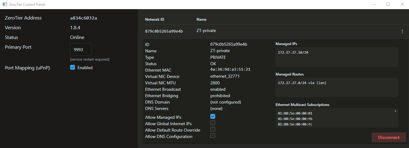

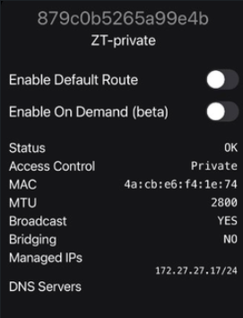

Download the ZeroTier app for your mobile phone or computer and join your newly created network:
Via our Laptop ZeroTier application we join the 879c0b5265a99e4b network;
User Zerotier mobile app to join the 879c0b5265a99e4bnetwork;
Also all other new hosts you have to authorize under the /zerotier/controller/member/ section.
