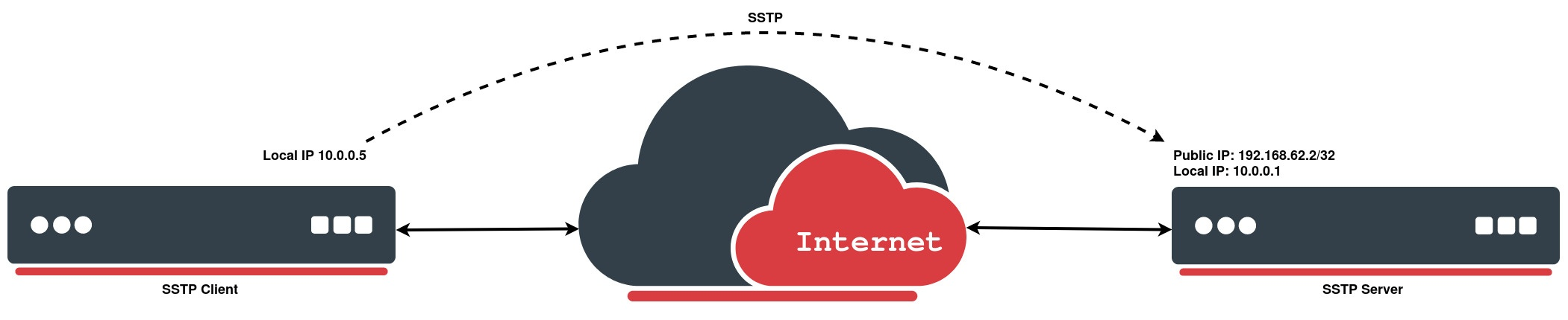

Quick Example
SSTP Client
In the following configuration example, we will create a simple SSTP client without using a certificate:
[admin@MikroTik] > /interface/sstp-client/add connect-to=192.168.62.2 disabled=no name=sstp-out1 password=StrongPass profile=default-encryption user=MT-User
[admin@MikroTik] > /interface/sstp-client/print
Flags: X - disabled; R - running 0 R name="sstp-out1" max-mtu=1500 max-mru=1500 mrru=disabled connect-to=192.168.62.2:443 http-proxy=0.0.0.0:443 certificate=none verify-server-certificate=no verify-server-address-from-certificate=yes user="MT-User" password="StrongPass" profile=default-encryption keepalive-timeout=60 add-default-route=no dial-on-demand=no authentication=pap,chap,mschap1,mschap2 pfs=no tls-version=any
### SSTP Server
We will configure PPP secret for a particular user, and afterwards simply enable an SSTP server:
```ros
[admin@MikroTik] > /ppp/secret/add local-address=10.0.0.1 name=MT-User password=StrongPass remote-address=10.0.0.5 service=sstp
[admin@MikroTik] > /interface/sstp-server/server/set default-profile=default-encryption enabled=yes
[admin@MikroTik] > /interface/sstp-server/server/print
enabled: yes
port: 443
max-mtu: 1500
max-mru: 1500
mrru: disabled
keepalive-timeout: 60
default-profile: default-encryption
authentication: pap,chap,mschap1,mschap2
certificate: none
verify-client-certificate: no
pfs: no
tls-version: any
In P2P setups the network address will be the same as the other endpoint's local address.
