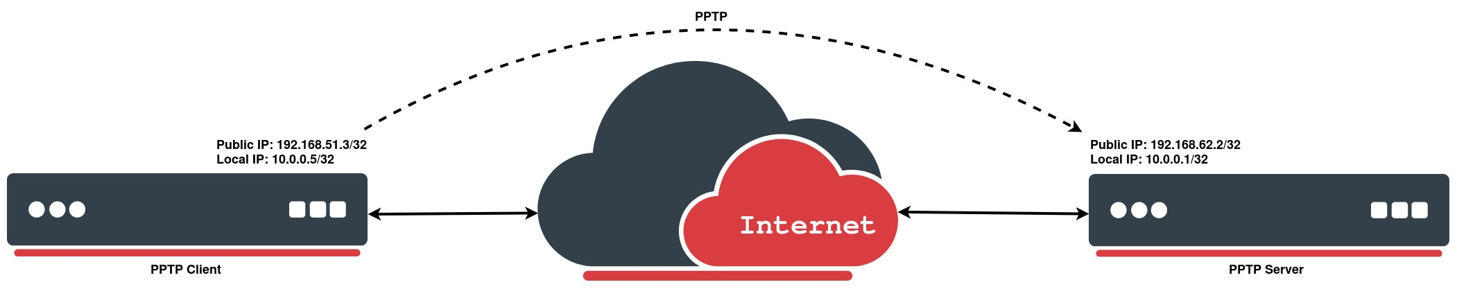

Example​
PPTP Client​
The following example demonstrates how to set up a PPTP client with username "MT-User", password "StrongPass" and server 192.168.62.2:
[admin@MikroTik] > /interface/pptp-client/add connect-to=192.168.62.2 disabled=no name=pptp-out1 password=StrongPass user=MT-User
[admin@MikroTik] > /interface/pptp-client/print
Flags: X - disabled; R - running
0 R name="pptp-out1" max-mtu=1450 max-mru=1450 mrru=disabled connect-to=192.168.62.2 user="MT-User"
password="StrongPass" profile=default-encryption keepalive-timeout=60 add-default-route=no
dial-on-demand=no allow=pap,chap,mschap1,mschap2
PPTP Server​
On the other side, enable the PPTP server and create a PPP secret for a particular user:
[admin@MikroTik] > /interface/pptp-server/server/set enabled=yes
[admin@MikroTik] > /ppp/secret/add local-address=10.0.0.1 name=MT-User password=StrongPass profile=default-encryption remote-address=10.0.0.5 service=pptp
[admin@MikroTik] > interface pptp-server print
Flags: D - dynamic; R - running
Columns: NAME, USER, MTU, CLIENT-ADDRESS, UPTIME, ENCODING
# NAME USER MTU CLIENT-ADDRESS UPTIM ENCODING
0 DR <pptp-MT-User> MT-User 1450 192.168.51.3 44m8s MPPE128 stateless
